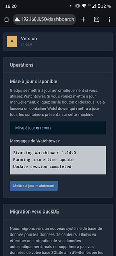

FYI, I just tested the ‘update’ button and
It doesn’t work
But no stress, it’s not vital :wink:
Edit : After several attempts to find the lines in the logs, it worked.

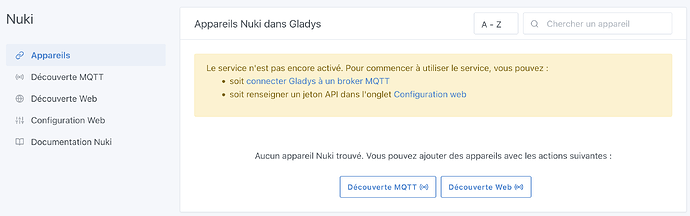

Now that Gladys is operational, I can see in the integration that Nuki is not enabled:
Personally I don’t have a Nuki lock so I don’t need the integration (for now).
Is it normal for the Nuki service to start and request a token on Gladys startup?

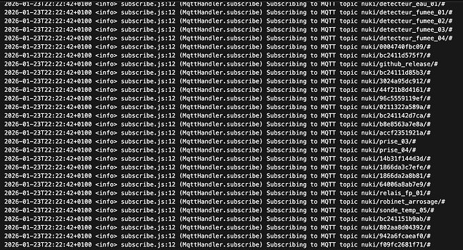

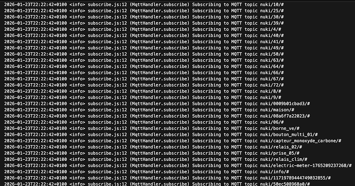

EDIT: and I have a bunch of strange things with MQTT:
The first lines with the numbers are my Z-Wave devices, then virtual MQTT devices, then z2m
However I don’t see anything appearing with MQTT Explorer.

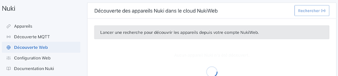

Another point: even if the service is not enabled, you can still start a search, same for the web:

On the Gladys side, we launch Watchtower with --run-once. Normally it’s supposed to work directly, but maybe something didn’t work on your side. If we observe this phenomenon from time to time we can report it to Watchtower!

That’s normal, however I agree that the service could display a clearer message in the case the user doesn’t intend to use the integration.
@ProtZ for info, normally services should throw new ServiceNotConfiguredError('') if they are not configured, which displays a clear message in the logs. It’s my fault, I hadn’t noticed that it was missing in your PR :smiley:
