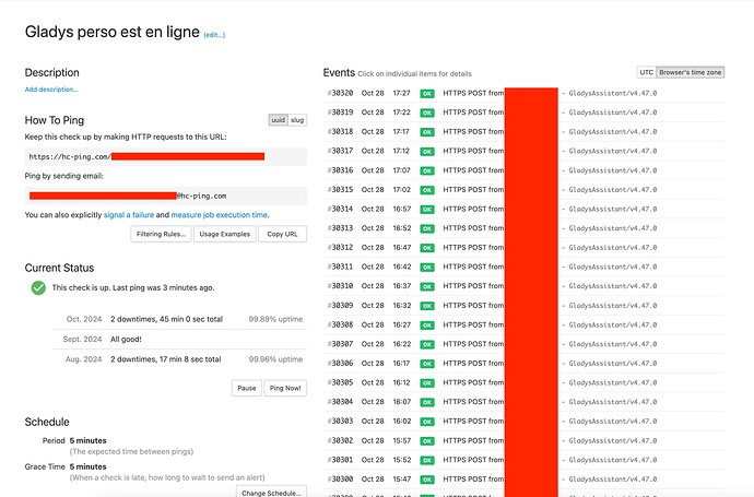

On that point, I use on my side a (free) service called https://healthchecks.io/, and honestly it does the job so well I don’t even know if we need a native feature :joy:
I created a healthcheck on their site:
I got the URL.
Then I have a scene in Gladys that pings the healthcheck every 5 minutes:
If one day Gladys or the internet is down at my place, I see it right away — I receive an email; it’s possible to have notifications on lots of services (WhatsApp, Telegram, ntfy, etc…)
I occasionally see disconnections when my internet router updates (around 2-3 AM in general)
