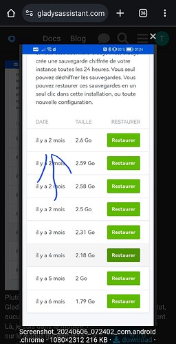

I agree with the request, however I don’t understand why you say you are losing 2 months of data :thinking:
If he uses Gladys Plus to retrieve
Yes OK I understand then.

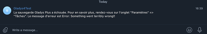

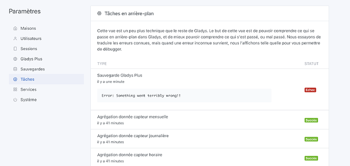

Hi @GBoulvin, as promised I looked into the issue :slight_smile:
I added a Telegram alert if a backup fails.
For example, if the error is:
The user will receive:
The PR:
What do you think?
