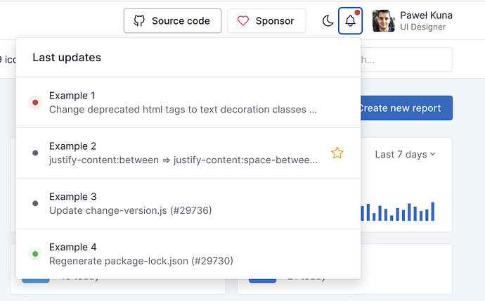

  • If it’s a notification in the sense of:
Then that’s a whole discussion that needs to be addressed :slight_smile: I think it’s a nice piece of work.
Your screenshot is representative of what I imagine.
« New Gladys version 4.15.0 — more information on the forum Â»

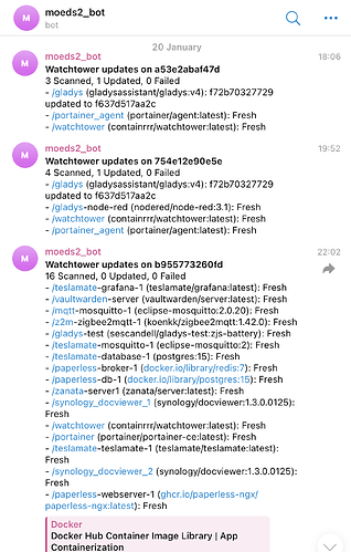

On my side I added Telegram notifications to Watchtower, which allows me to see which containers have been updated with a basic report. Admittedly it sends notifications every day but at least I know what’s going on.
Voici ce que ça donne dans mon docker compose :

and this is what it looks like (I have 3 Docker instances with Watchtower on each) :
Nice notification message :star_struck:
I’ll snag it for my servers, it’s more explicit and less verbose than the default logs :grin:

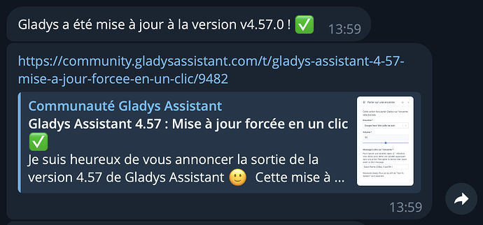

Hello everyone!
Gladys will now send a notification to administrators when Gladys has been updated, in their language and with a link to the release post:
The PR:
This new feature is available in Gladys Assistant 4.58 :
