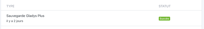

No, that’s not it! This task is the Zigbee2mqtt backup.
It looks like this:
