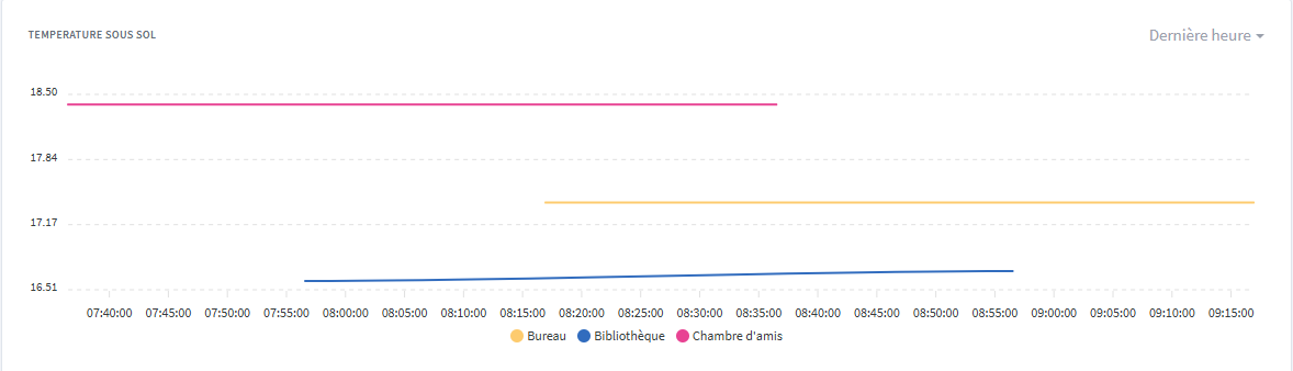

Charts empty in 1h mode and functional in 24h mode

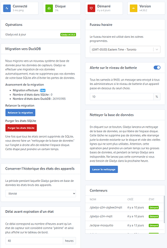

Brand-new installation, with local access (web / ssh) and up to date.

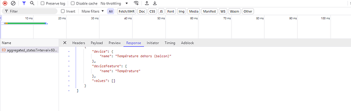

Could you open the browser inspector and check what happens with that request at the moment you switch charts?
Actually, I tried several times and I don’t see anything in the browser console.
Are you sure you’re really there? (locally, not via Gladys Plus) :
I was in the « console » tab🤦

Okay, it might be related to DuckDB — I’d be curious to know whether the issue persists over the next few hours now that you no longer have aggressive outbursts every 5 seconds.

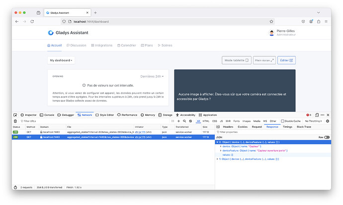

That’s crazy! In this case there must be something different on your instance because that works fine :grinning_face_with_smiling_eyes:
That’s crazy, yeah!
But I installed everything properly to avoid this :sweat_smile::sweat_smile:

Are you sure it’s not a timestamp issue? For the 24h view we fetch all values from 24 hours ago, so the latest ones appear and are rendered with the correct time because it’s the display
as for me it’s not KO
but there are still gaps when it’s on 1 hour as well
both at the front and the back of the graph but on 24 hours no problem
and likewise the sensors are all the same so I suppose the reports are roughly on the same timing

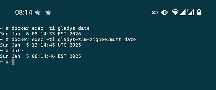

I think I have a lead.
Gladys is on the America/Toronto time zone. However the Zigbee2MQTT container is not running on the same time zone.
I just reinstalled everything, with Gladys Plus restoration. So the values are less than an hour old.
If I check the dates manually in the containers:
But since Gladys displays the correct times, I imagine that it handles dates in UTC.
EXCEPT THAT I modified the date in the Zigbee2MQTT container (before the restoration), because my thermostats are set to the correct time via a message from Z2M. So it was a problem for me that Z2M was in UTC; the time on my thermostats was displayed in UTC.

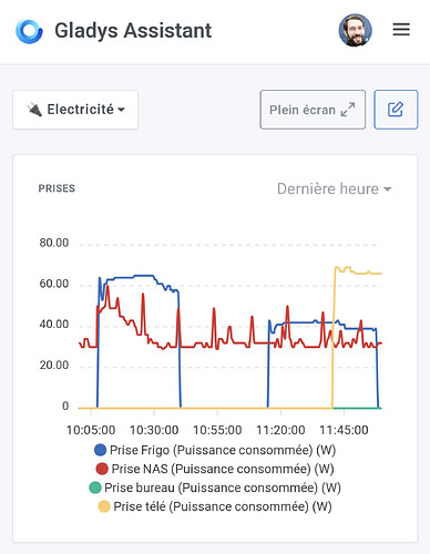

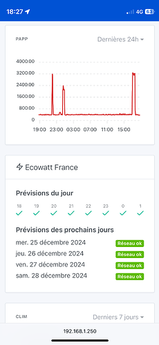

I don’t know if this relates to this issue but I was in GMT-04 during these winter holidays, phone set to local time.
When I looked at the graphs on my phone connected via VPN to my home, I saw the graphs in GMT-04, i.e. with a 5-hour offset compared to the Gladys at home.
The 3000W spike in the photo corresponds to the water heater starting at 22:00 but shows a start at 17:00 :confused:

I think you’re right. The chart displays the last point at the current time (around 10:00) and the first point in Paris time (about 16:00, i.e. 10:00 local + 6h).
Of course the display of the last hour isn’t working because it’s probably shifted.
Yet Gladys is indeed set to TZ=America/Toronto, I manually applied that on z2m as well, but it’s still the same thing.
Yes, the z2m settings won’t change anything. The data in the database is written by Gladys on its created_at and updated_at. Gladys does not take the actual data capture value but the one of the write to the database.
We must just have a formatting issue on the request (taking local time into account … or something else). Just a guess, I haven’t looked.
