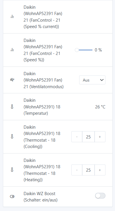

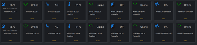

Part 1: Getting the Data from Onecta (2 Devices) … perfect and smooth
Part 2: Devices in Matterbridge… OK … configuration possible

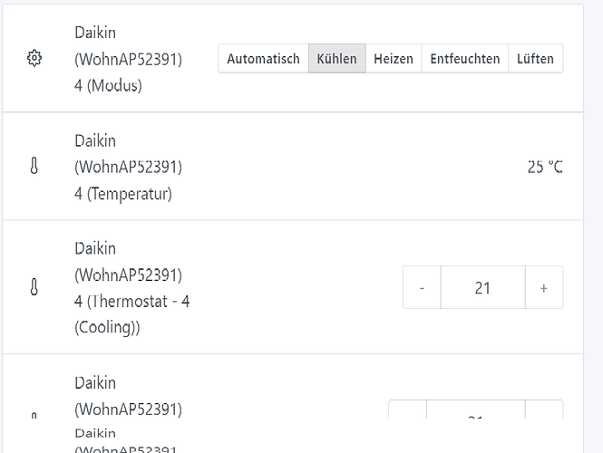

Part 3: Devices in Gladys: … OK … here they are:
But: No On/Off Possibility … can’t start or stop them
No Possibility to switch between cooling and/or heating.
Developer describes: … on/off and status change are possible…
https://github.com/mehmetc/matterbridge-daikin-onecta
https://github.com/mehmetc/matterbridge-daikin-onecta/blob/main/README.md
Daikin 21: No Speed Control is shown
Daikin 21: Fan Speed Control possible
Daikin 21: Fan Mode possible (Slow - Fast etc.)
Daikin 18: Temperature possible
Daikin Boost: Boost mode possible
I tried a few configurations in Matterbridge, but nothing changed … no On/Off or mode change
What can I do?

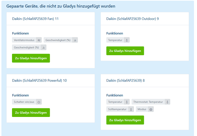

1.) Two air conditioners with cooling and heating functions are expected in Matterbridge on the Onecta Cloud:
Result: Completed
2.) Gladys Assistant - Integration - Matter:
Four devices are supported per unit.
Device 1: temperature (external),
Device 2: ventilation mode, speed (%), and speed (%)
Device 3: switch (on/off mode)
Device 4: temperature, thermostat temperature, setpoint temperature, mode
Result: Test successful

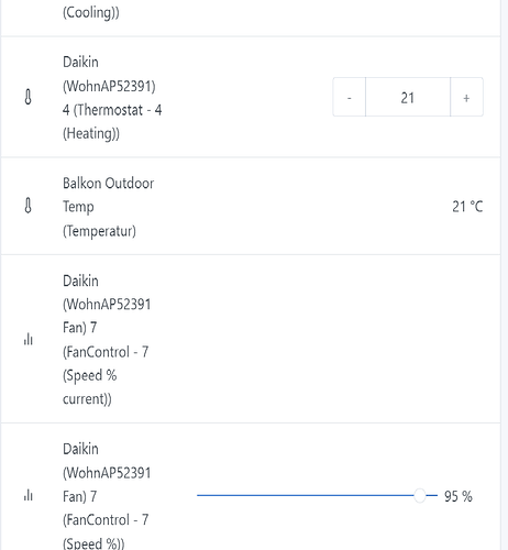

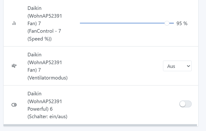

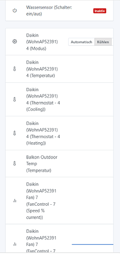

3.) Gladys Assistant - Test Page - Device Display - All selected functions
Result: Test successful, all displays are functional
… and why not the expected 12 points? The device turns on and works, but unfortunately, it does not turn off :frowning:

As expected, the two AC are here…
Under Gladys - Integrations - Matter, you will find the following for each AC:
Select every Function:
The air conditioner turns on when you click on:
Mode: Auto, Cooling, Heating, Dehumidification, Ventilation
et
Powerful (Boost Mode)
The air conditioner is adjustable, for example in terms of temperature or fan speed.
It cannot be turned off :frowning:
Hi @ruegerth, thanks for your message and for taking the time to test! :blush:
I’m not sure I fully understood your issue. Could you use an AI (ChatGPT, Claude, etc.) to rephrase your message in English or French? Google Translate can sometimes be a bit off, and I’m afraid I might misinterpret your needs.
On his end, @prohand tested with his setup and everything worked fine. So, I think the development on the Gladys side is good. Now, we need to look at what’s happening on the Matterbridge or plugin side to understand the root of the problem.
Anyway, I’ve merged the development into master, so it will be included in the next Gladys release! :rocket:
Hello, I’m trying it in all three languages, in descending order of quality.
The Daikin Onecta air conditioners arrive in Matterbridge as shown and are passed on to Gladys Assistant. There, I can turn them on by clicking one of the displayed modes or starting the power mode. After that, it’s possible to control the displayed options, e.g., temperature or fan speed. BUT: Turning them off is not possible. I’ve tried all the offered options, e.g., mode change, power on and off, etc. No turning off.
French:
In other words, the only difficulty is the inability to turn them off.
But: in any case, a big thank you for the quick and complete help.
Thank you very much for Gladys Assistant and your work
Best regards from Thomas
Hi,
From my end, the extinction works fine :slight_smile:
Great, I’m glad to hear that it’s working. It must therefore come from my equipment and not from the plugin or Gladys. Thank you very much
