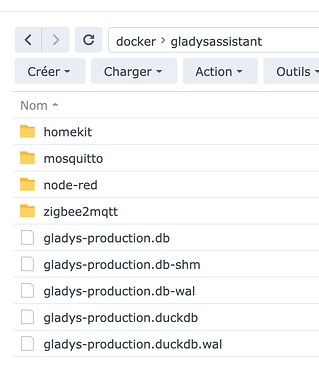

I have a doubt about the storage folder. I created it and modified the script from the manual, but it’s empty… How can I check that everything is correct?
I don’t use Zigbee modules; I have quite a few bulbs, smart plugs and Hue remotes, and Meross Wi‑Fi modules recognized in Apple Home and Home Assistant.
Thanks again for your help.

You should have things like this:
![image|426x500, 75%](upload://lNafYvBdj
None of that.
I think QNAP’s Container Station must be different from Synology’s, and as a result the script is probably not suitable even though I modified the path like this:
\-v /DataVol1/docker/gladysassistant/:/var/lib/gladysassistant \\\
And since I don’t know anything about creating Docker containers, I’d rather not venture further.
Have a good evening.
Sincerely,
Yann.

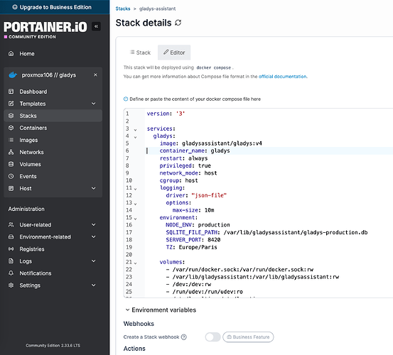

To check:
  • path of the directory because I found /share/Container/ on several sites including the one mentioned above
  • make sure to give read-write (RW) rights on the directory to your user who created the docker to avoid write permission issues.
If needed, I can guide you on Portainer because I use this service a lot.
Here’s the example on my setup:
Hello and thank you for the time spent and these tips.
The integration of Portainer on the QNAP as explained in the link went smoothly.
Note that it was done inside Container Station by creating an application.
Then I pasted the script (thanks) into Portainer after checking the storage path.
Then deployed it as in the example from the link.
After that I found Gladys and Watchtower in Container Station with a message telling me that the Docker containers will have limitations because they come from outside.

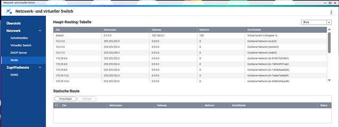

Problem: This IP6 must be manually added as a route.

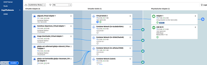

Hi @Yann_Gourrier,
here is the approach to error analysis. Start the « Network and Switch Â» app on the QNAP, then set « Advanced Â» at the bottom left.
Then click on « Overview Â» on the left. Result: QNAP shows you exactly which Docker uses which virtual switch and how the path to the internet is. If it doesn’t match, Gladys says … nothing reached …
Then turn off the firewall in QNAP, which is often present and active, for testing purposes.
It seems there is a routing problem on your Gladys. It runs, but it can’t find its way out. You can check this with the same app. Simply click on Route on the left in advanced mode and you get:
There you can see exactly how each interface (see above) is running…
Ultimately, there are two approaches: If Gladys works locally but cannot access the internet, then it is a network routing issue. That is, the virtual switch for the internal Docker network does not get out … Routing problem
Gladys runs in the Container Station, but for example is not accessible locally, then it is often due to the network configuration in the YAML.
