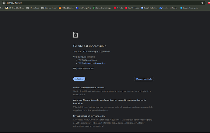

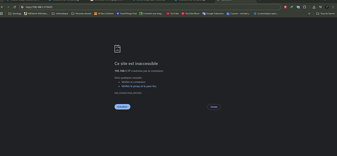

I followed the procedure to the letter and everything went as described in the procedure. But when I log in with my IP address plus 8420, this is what appears:
I’ve tried with several browsers, same problem
Do you have a solution?
Show us the exact address you entered. There might be an error.

As @Will_71 says, we should check what you entered in the address bar, and I’ll add the detail (bottom right of your screenshot).
On first launch, it can take up to 5 minutes for Gladys to initialize, after which it’s accessible.
Were you able to try again later?
Thank you for your feedback
In my address bar 192.168.1.17:8420
And when I click it, I get this:
Thank you.
Thanks, are you on http or https?
I can’t see it :confused:
I tried the two

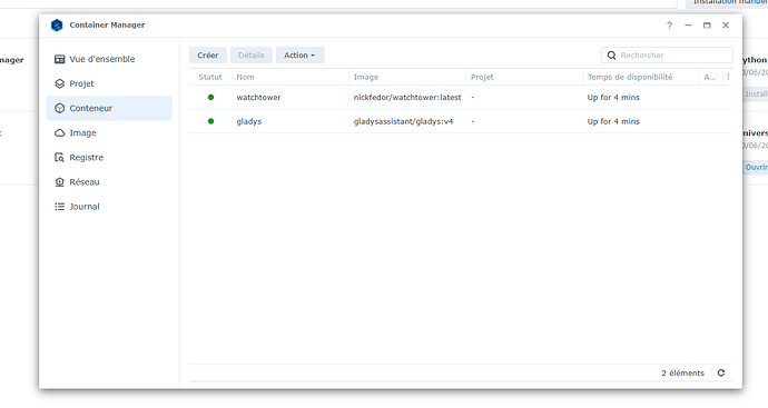

Maybe a silly question but are you sure the Gladys container is operational (green dot in the list of containers)?

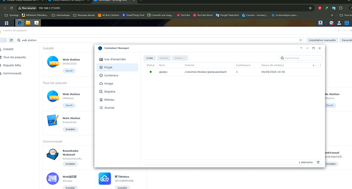

I’m following up on @GBoulvin’s comment to see if there are any files that have been created in the /docker/gladysassistant directory (or whatever you’ve set) in File Station?
Yes, the green dot is indeed the green dot

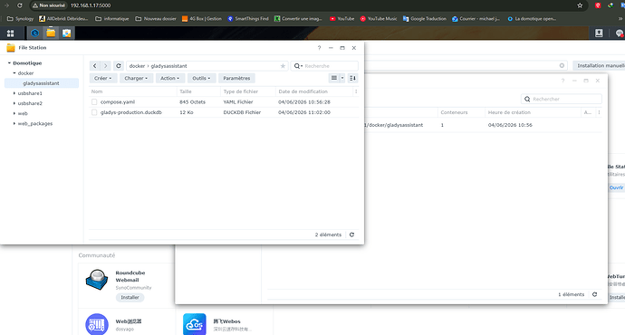

I’m sending you screenshots

Thanks for the screenshots!
From what I see in the gladysassistant directory, not all files are created, so it’s normal that you get this message in the web browser.
However, I’m having trouble figuring out why Gladys initialization isn’t completing. I’m stuck on this part.

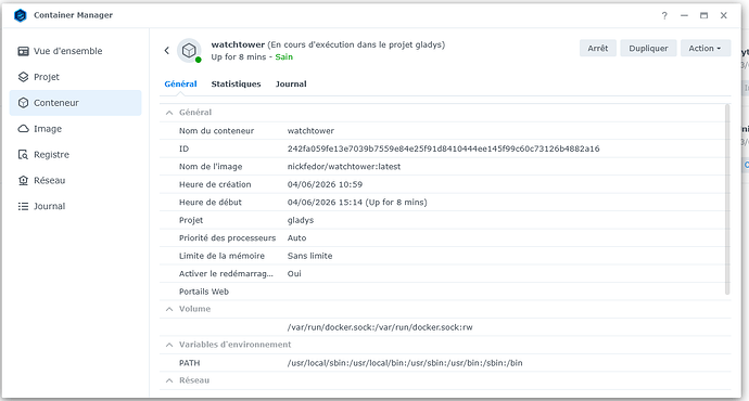

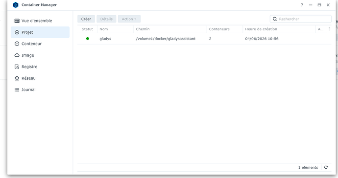

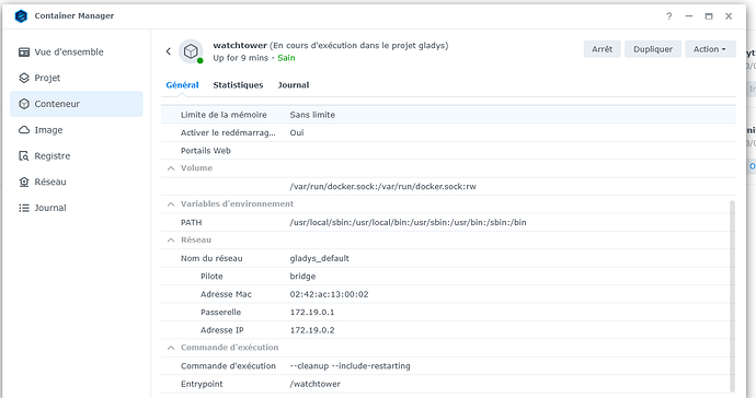

Could you take a screenshot of your Container page? In the project, I see 1 container, but there should be 2 (gladys and watchtower).
@pierre-gilles Do you have any ideas or leads to explore?

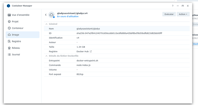

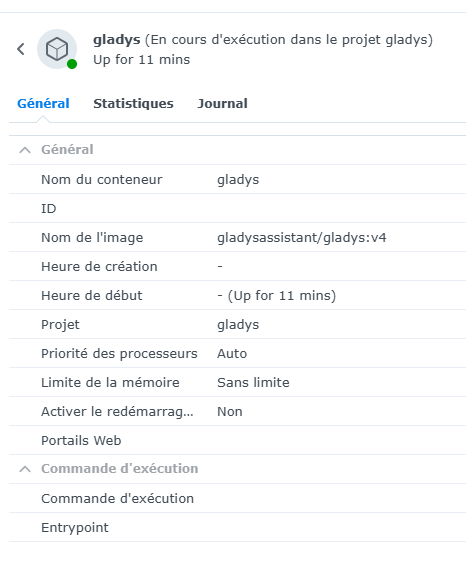

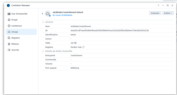

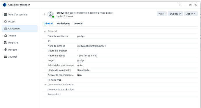

Here are screenshots of my container
Container Image Screenshots

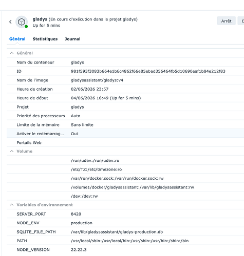

There is indeed an issue with the Gladys container as there are no volumes, environment variables, or even the execution command or Entrypoint: it’s all empty :roll_eyes:
On my end, I have:
