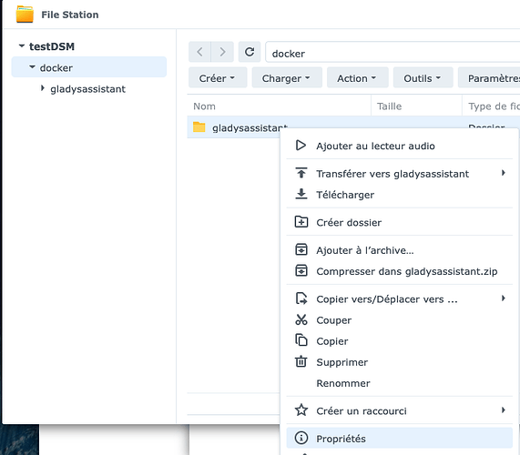

We then continue by creating a storage directory for Gladys:
Finally, we retrieve the path of the directory (which we will use later) by displaying its properties:

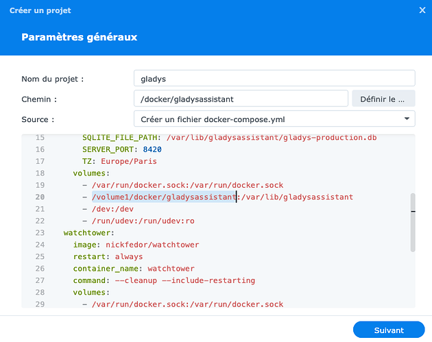

In Container Manager, go to Project then Create:
Then we fill in the fields and copy/paste the following docker compose:

You will need to modify /volume1/docker/gladysassistant (if necessary) with the path of the directory retrieved earlier.
The port 8420 of SERVER_PORT: 8420 can be changed according to your configuration or if it is already in use. Avoid ports used by Synology and some native applications.
We validate with Next.

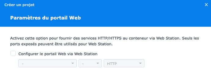

After that, there is no obligation to select the Web Portal (unless needed but you will normally have to install the Web Station package):

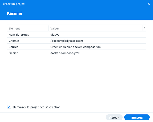

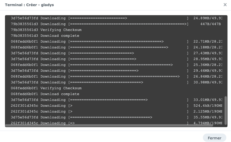

Finally, we can validate the project which will start right after:

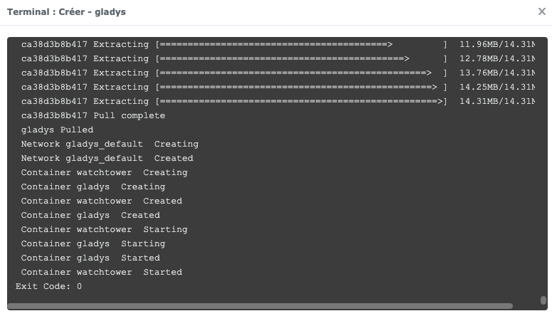

The creation of the project with the download and launch of the files will be visible in real-time, this will take several minutes:

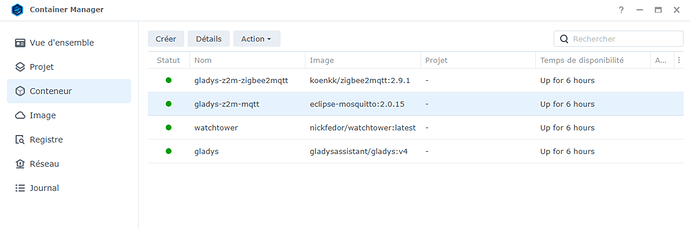

Once finished, the Gladys and Watchtower containers start:
→ We now have 1 project and 2 containers:

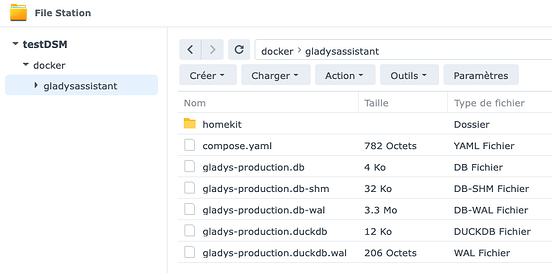

And the data files of Gladys:
