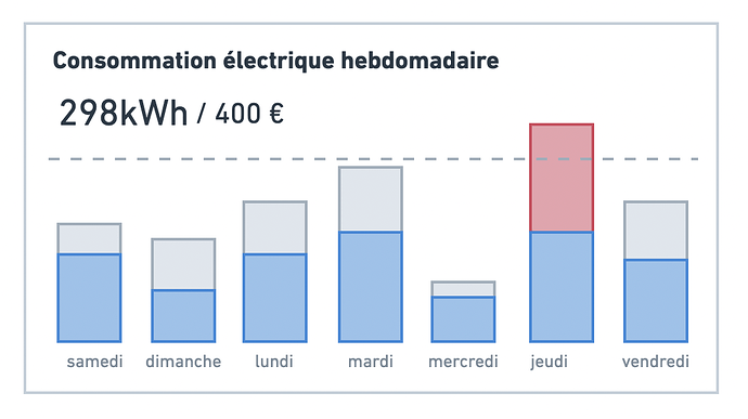

A graph that allows stacking HP and HC indices. (I specify because today we can’t do that)
In graphs, the ability to select a live data point.
I like the mockup :slight_smile:
In a broader reflection, wouldn’t it be better to separate the counters from the integrations? That would allow everyone to select their data source.
Something like this (to be defined for the color codes)?

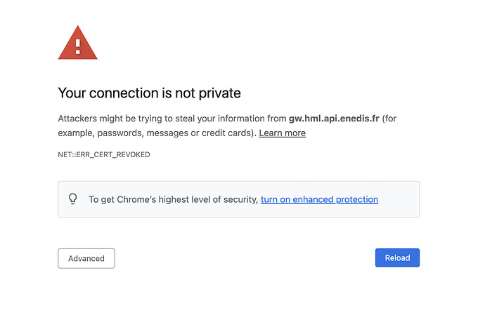

For your information, I was planning to continue on the topic today but Enedis’ sandbox is down (this is often the case, unfortunately)
Today it’s the certificate that’s expired…
I’ve contacted Enedis, I’ll resume as soon as they’re back up!
