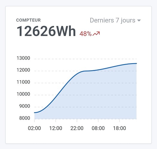

I’m following up on the chart display
on the « 7 days » view, shouldn’t I have the days displayed instead of the hours?

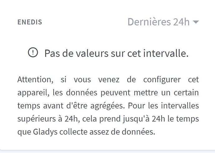

I did connect to Enedis from Gladys, I synchronized and created a graph but I get no data:

Yes, that’s normal, these charts will never have any data; the Enedis integration is only useful for historical data, there is no live data.
We could hide them indeed, but my aim is rather to develop a component specific to energy consumption (step 2 of this development) that will be dedicated to this functionality.
The « last 24h » chart will never return anything in the case of the Enedis integration (which only returns historical data)

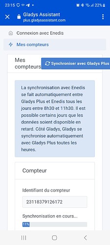

Did you try doing a full sync on the Enedis integration side? (Button « Synchronize with Gladys Plus »)
Note: After a full sync, the data will only be shown after the next hour on the dashboard, due to hourly aggregation

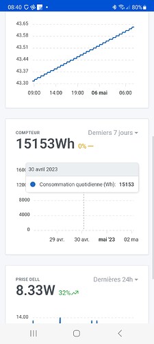

@pierre-gilles how does the sync work?
Because I did a sync 4 days ago and now I see that my data is as of May 7.
Well, after 2 days of normality.

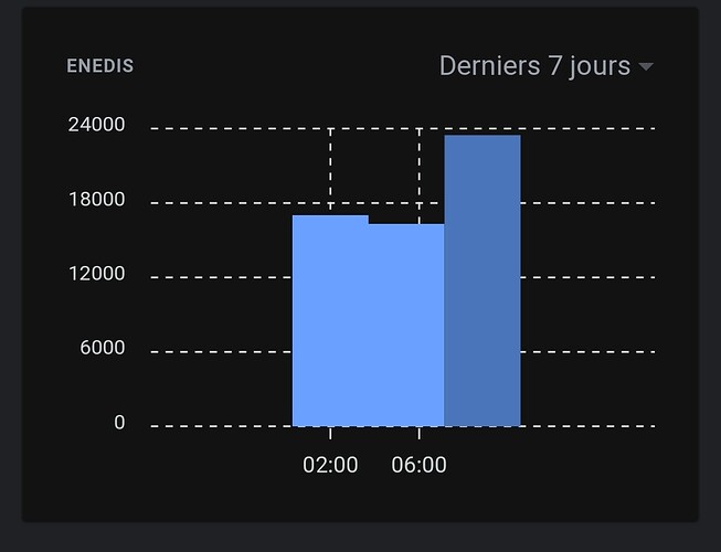

Here is the 7-day graph with hours again
I don’t understand anything anymore!
Same here, which is why I asked yesterday
I tried syncing again yesterday but it didn’t work
