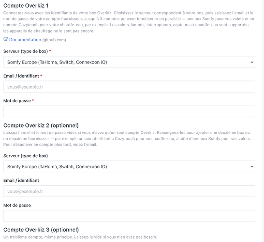

If you’re comfortable with the idea of testing, you need to:
  • uninstall the Overkiz integration
  • click the blue Install from Github button
  • click Developer mode
  • specify this image ghcr.io/cicoub13/gladys-overkiz:feat-multi-account
  • paste the manifest (content of this file)
  • Install
You will be able to configure up to three accounts :star_struck:

I configured my 2 accounts. Once the registration is done, here is the message when I click on the first button « Test the connection Â» :
Account 1 (Atlantic Cozytouch): Connection to the Overkiz API failed: this.externalId is not a function · Account 2 (Somfy Europe): Connection to the Overkiz API failed: this.externalId is not a function / Account 1 (Atlantic Cozytouch): Connection to the Overkiz API failed: this.externalId is not a function · Account 2 (Somfy Europe): Connection to the Overkiz API failed: this.externalId is not a function
