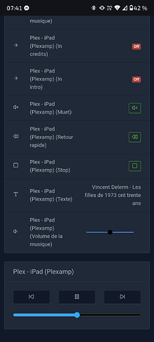

Salut !
Merci pour cette intégration ! Tu as été plus rapide que moi pour la release, j’avais une version en test mais je n’en étais pas encore satisfait :zany_face:
J’ai bien un retour d’info mais je n’arrive pas à contrôler la musique de plexamp sur l’iPad (rien du tout). Rien d’explicite dans les logs :
[2026-08-16T05:26:02.094Z] [INFO] onConfigUpdated -> new configuration received
[2026-08-16T05:26:02.103Z] [INFO] [plex-monitor] Connected to Plex server "gladys" (v1.43.3.10861-07dfddaeb)
[2026-08-16T05:26:02.411Z] [INFO] [plex-notifications] Connected to the Plex notification socket
[2026-08-16T05:26:04.920Z] [INFO] [plex-monitor] Connected to Plex server "gladys" (v1.43.3.10861-07dfddaeb)
[2026-08-16T05:26:18.383Z] [INFO] onDeviceCreated <- ext:ext-guim31-gladys-plex:server:2b588884a92967f7f95cb7f55784f2dd5468ac73
[2026-08-16T05:32:58.442Z] [INFO] [plex-monitor] New Plex player discovered: iPad
[2026-08-16T05:33:54.106Z] [INFO] onScanRequest -> publishing 2 devices
[2026-08-16T05:33:57.652Z] [INFO] onDeviceCreated <- ext:ext-guim31-gladys-plex:player:b8474c9e-6b33-454e-8594-14ba25f9babd
[2026-08-16T05:35:44.327Z] [INFO] onSetValue <- ext:ext-guim31-gladys-plex:player:b8474c9e-6b33-454e-8594-14ba25f9babd:pause = 1
[2026-08-16T05:36:05.254Z] [INFO] onSetValue <- ext:ext-guim31-gladys-plex:player:b8474c9e-6b33-454e-8594-14ba25f9babd:play = 1
[2026-08-16T05:36:06.530Z] [INFO] onSetValue <- ext:ext-guim31-gladys-plex:player:b8474c9e-6b33-454e-8594-14ba25f9babd:previous = 1
[2026-08-16T05:36:21.819Z] [INFO] onSetValue <- ext:ext-guim31-gladys-plex:player:b8474c9e-6b33-454e-8594-14ba25f9babd:next = 1
[2026-08-16T05:36:36.768Z] [INFO] onSetValue <- ext:ext-guim31-gladys-plex:player:b8474c9e-6b33-454e-8594-14ba25f9babd:stop = 1
[2026-08-16T05:36:47.420Z] [INFO] onSetValue <- ext:ext-guim31-gladys-plex:player:b8474c9e-6b33-454e-8594-14ba25f9babd:forward = 1
[2026-08-16T05:36:50.634Z] [INFO] onSetValue <- ext:ext-guim31-gladys-plex:player:b8474c9e-6b33-454e-8594-14ba25f9babd:mute = 1
[2026-08-16T05:36:52.369Z] [INFO] onSetValue <- ext:ext-guim31-gladys-plex:player:b8474c9e-6b33-454e-8594-14ba25f9babd:rewind = 1
Je veux bien que tu demandes à ton ‹ nouvel ami › d’ajouter l’utilisation des webhooks (j’ai un Plex pass et GladysPlus) car ça permet de ne pas attendre le poll de 10s.
Édit : j’utilise Plexamp pour la musique. Peut-être que le suivi vient de là ?

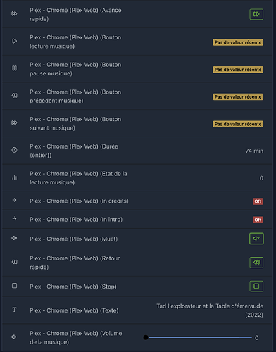

J’ai actuellement un soucis avec plex client chrome (pas encore test la TV) :
je ne sais pas pk j’ai pas de valeur récente à la place de push button.
Les push button ne réagisse pas a l’exception du stop le volume pareil ne semble pas agir non plus :slight_smile:
Et on ne juge pas le media c’est pour ma fille :eyes: :stuck_out_tongue:
log :
[2026-08-16T10:04:00.117Z] [INFO] Starting the Plex integration...
[2026-08-16T10:04:00.307Z] [INFO] [gladys-sdk] connected to Gladys (http://172.30.0.1:8455)
[2026-08-16T10:04:00.322Z] [INFO] Waiting for the Plex configuration (URL + token)
[2026-08-16T10:10:22.832Z] [INFO] onConfigUpdated -> new configuration received
[2026-08-16T10:10:22.832Z] [INFO] Waiting for the Plex configuration (URL + token)
[2026-08-16T10:11:13.870Z] [INFO] onConfigUpdated -> new configuration received
[2026-08-16T10:11:13.907Z] [INFO] [plex-monitor] Connected to Plex server "DiskStation" (v1.43.2.10687-563d026ea)
[2026-08-16T10:11:14.437Z] [INFO] [plex-notifications] Connected to the Plex notification socket
[2026-08-16T10:11:20.384Z] [INFO] onConfigUpdated -> new configuration received
[2026-08-16T10:11:20.391Z] [INFO] [plex-monitor] Connected to Plex server "DiskStation" (v1.43.2.10687-563d026ea)
[2026-08-16T10:11:20.566Z] [INFO] [plex-notifications] Connected to the Plex notification socket
[2026-08-16T10:11:21.853Z] [INFO] [plex-monitor] Connected to Plex server "DiskStation" (v1.43.2.10687-563d026ea)
[2026-08-16T10:11:41.734Z] [INFO] onDeviceCreated <- ext:ext-guim31-gladys-plex:server:a8058595a4bb5a3537614ec74ebdf3c644e8d14e
[2026-08-16T11:39:01.060Z] [INFO] [plex-monitor] New Plex player discovered: Chrome
[2026-08-16T11:40:14.880Z] [INFO] onDeviceCreated <- ext:ext-guim31-gladys-plex:player:ed9ht57db2wn25la3vfyjnpo
[2026-08-16T11:41:30.401Z] [INFO] onSetValue <- ext:ext-guim31-gladys-plex:player:ed9ht57db2wn25la3vfyjnpo:volume = 22
[2026-08-16T11:41:31.140Z] [INFO] onSetValue <- ext:ext-guim31-gladys-plex:player:ed9ht57db2wn25la3vfyjnpo:volume = 11
[2026-08-16T11:41:41.139Z] [INFO] onSetValue <- ext:ext-guim31-gladys-plex:player:ed9ht57db2wn25la3vfyjnpo:volume = 0
[2026-08-16T11:41:42.369Z] [INFO] onSetValue <- ext:ext-guim31-gladys-plex:player:ed9ht57db2wn25la3vfyjnpo:volume = 7
[2026-08-16T11:41:43.282Z] [INFO] onSetValue <- ext:ext-guim31-gladys-plex:player:ed9ht57db2wn25la3vfyjnpo:volume = 0
[2026-08-16T11:41:54.712Z] [INFO] onSetValue <- ext:ext-guim31-gladys-plex:player:ed9ht57db2wn25la3vfyjnpo:mute = 1
[2026-08-16T11:41:57.426Z] [INFO] onSetValue <- ext:ext-guim31-gladys-plex:player:ed9ht57db2wn25la3vfyjnpo:mute = 1
[2026-08-16T11:42:11.046Z] [INFO] onSetValue <- ext:ext-guim31-gladys-plex:player:ed9ht57db2wn25la3vfyjnpo:stop = 1
[2026-08-16T11:42:11.066Z] [INFO] [plex-monitor] Session of ed9ht57db2wn25la3vfyjnpo terminated server-side (stop fallback)
[2026-08-16T11:42:33.547Z] [INFO] onSetValue <- ext:ext-guim31-gladys-plex:player:ed9ht57db2wn25la3vfyjnpo:mute = 1
ps : Testé sur android via l’application même soucis :frowning:

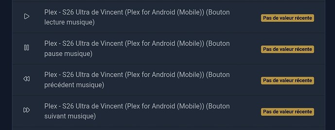

[2026-08-16T16:27:40.274Z] [INFO] [plex-monitor] New Plex player discovered: S26 Ultra de
[2026-08-16T16:27:59.153Z] [INFO] onDeviceCreated <- ext:ext-guim31-gladys-plex:player:cxus6yubstmxb3mw0sr8if7b
[2026-08-16T16:30:35.319Z] [INFO] onSetValue <- ext:ext-guim31-gladys-plex:player:cxus6yubstmxb3mw0sr8if7b:mute = 1
[2026-08-16T16:30:35.320Z] [WARN] [plex-monitor] Player cxus6yubstmxb3mw0sr8if7b does not advertise the "playback" capability; trying anyway (enable "Advertise as player" in its Plex app if nothing happens)
[2026-08-16T16:30:42.329Z] [INFO] onSetValue <- ext:ext-guim31-gladys-plex:player:cxus6yubstmxb3mw0sr8if7b:volume = 21
[2026-08-16T16:30:42.329Z] [WARN] [plex-monitor] Player cxus6yubstmxb3mw0sr8if7b does not advertise the "playback" capability; trying anyway (enable "Advertise as player" in its Plex app if nothing happens)
[2026-08-16T16:30:45.383Z] [INFO] onSetValue <- ext:ext-guim31-gladys-plex:player:cxus6yubstmxb3mw0sr8if7b:volume = 76
[2026-08-16T16:30:45.383Z] [WARN] [plex-monitor] Player cxus6yubstmxb3mw0sr8if7b does not advertise the "playback" capability; trying anyway (enable "Advertise as player" in its Plex app if nothing happens)
[2026-08-16T16:30:50.571Z] [INFO] onSetValue <- ext:ext-guim31-gladys-plex:player:cxus6yubstmxb3mw0sr8if7b:volume = 37
[2026-08-16T16:30:50.571Z] [WARN] [plex-monitor] Player cxus6yubstmxb3mw0sr8if7b does not advertise the "playback" capability; trying anyway (enable "Advertise as player" in its Plex app if nothing happens)
[2026-08-16T16:30:51.264Z] [INFO] onSetValue <- ext:ext-guim31-gladys-plex:player:cxus6yubstmxb3mw0sr8if7b:volume = 5
[2026-08-16T16:30:51.264Z] [WARN] [plex-monitor] Player cxus6yubstmxb3mw0sr8if7b does not advertise the "playback" capability; trying anyway (enable "Advertise as player" in its Plex app if nothing happens)
[2026-08-16T16:30:57.906Z] [INFO] onSetValue <- ext:ext-guim31-gladys-plex:player:cxus6yubstmxb3mw0sr8if7b:rewind = 1
[2026-08-16T16:30:57.907Z] [WARN] [plex-monitor] Player cxus6yubstmxb3mw0sr8if7b does not advertise the "playback" capability; trying anyway (enable "Advertise as player" in its Plex app if nothing happens)
[2026-08-16T16:31:00.900Z] [INFO] onSetValue <- ext:ext-guim31-gladys-plex:player:cxus6yubstmxb3mw0sr8if7b:forward = 1
[2026-08-16T16:31:00.900Z] [WARN] [plex-monitor] Player cxus6yubstmxb3mw0sr8if7b does not advertise the "playback" capability; trying anyway (enable "Advertise as player" in its Plex app if nothing happens)
[2026-08-16T16:31:04.059Z] [INFO] onSetValue <- ext:ext-guim31-gladys-plex:player:cxus6yubstmxb3mw0sr8if7b:stop = 1
[2026-08-16T16:31:04.060Z] [WARN] [plex-monitor] Player cxus6yubstmxb3mw0sr8if7b does not advertise the "playback" capability; trying anyway (enable "Advertise as player" in its Plex app if nothing happens)
[2026-08-16T16:31:04.100Z] [INFO] [plex-monitor] Session of cxus6yubstmxb3mw0sr8if7b terminated server-side (stop fallback)

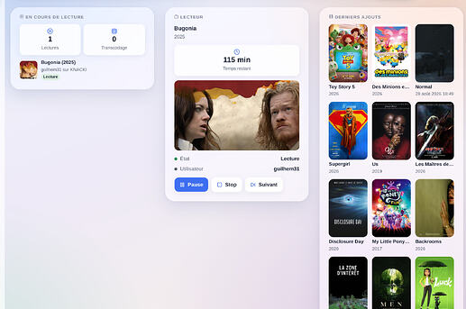

:framed_picture: Trois widgets
  • En cours de lecture : qui regarde quoi, sur quel lecteur, avec les affiches et un badge Lecture / Pause / Transcodage.
    Lecteur : la lecture en cours en télécommande, avec l’image de fond du film (ou la pochette de l’album), le titre, l’état, le temps restant en direct et les boutons Pause/Lecture, Stop, Suivant. Laissez son réglage vide pour qu’il suive automatiquement ce qui est en cours, ou choisissez un lecteur précis.
  • Derniers ajouts : une grille d’affiches des films, saisons et albums ajoutés récemment, avec un lien pour les ouvrir dans Plex.
Les images sont redimensionnées par votre serveur Plex et servies par l’intégration : le navigateur ne contacte jamais Plex, et votre token reste chez vous.
