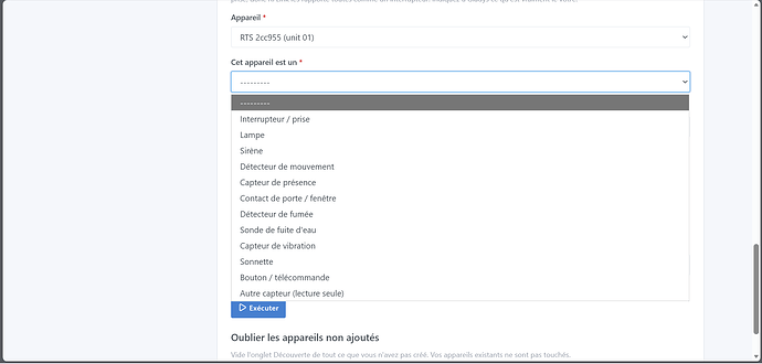

There is no shutter category in the device types in your application, is that normal?
Your application saw one of my shutter remote controls, but I don’t know what type of device I should assign to it to use it in Gladys.

The dropdown list you used is intended for other devices.
For the shutters, I think there is a pairing process to expose the shutters? I raised the subject with Claude so he can detail the operation. I’ll let you know as soon as I have news.
