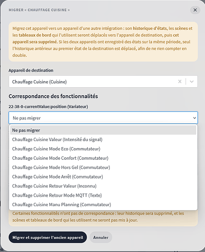

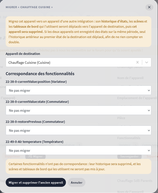

When I go to the internal integration and click on Migrate, a window opens and asks me to which device.
But it also tells me that some features will not be migrated because there is no match.
Are these features of the devices that were not used by Z-Wave JS UI in the internal integration and will be in the external one?
Or are these features that I simply wasn’t using?
I don’t know what to do?
You actually need to check if you were using them, otherwise there’s no need.
If they were used, then you need to check with @Sescandell if everything is the same, meaning if the old and new ones have the same features.
On some modules I have, there were differences due to the evolution of zwave-js and it was added or modified.
However, you would need the module info (name, model) because it’s difficult with just this screenshot.
Try it on the modules that have all their useful correspondences for you.
What are the options available in the dropdown where it says « do not migrate Â»? It might just be a renaming change.
Show me the options offered
The 4 features of the Internal version are those that will not be migrated to the External version.
The device is a Qubino Flush Pilot ZMNHJD: (I have 4 of them)
Screenshot 2026-10-04 at 20-47-25 Z-Wave JS UI
These Qubino devices now only have 4 features left:
I had to not migrate some features, I had no choice.
What you need to check is if you use them in scenes, that will be more complicated.

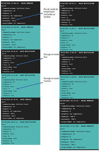

That’s surprising. Could you please give me the zwavejsui log that contains the device definition?
One explanation could be that the new module manages thermostats, which wasn’t the case before. And I can see values that look like a thermostat. The device’s JSON will help us see more clearly.

I got this information from the internal integration.
Is this what you wanted?
Or rather this?
DEBUG Z-Wave JZ UI
That second link was what I was interested in.
I’ll take a look as soon as I have a few minutes to see if I missed anything.

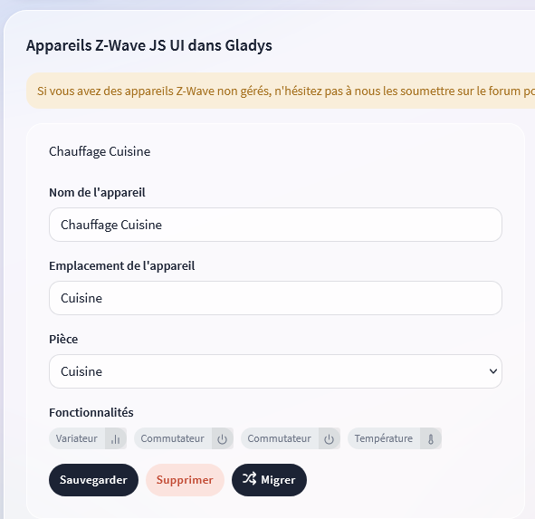

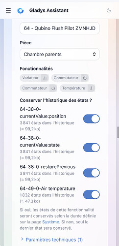

Could you please send me (specifying what each image is before it):
A screenshot of the device in your current integration.
A screenshot of the device in the external integration
On both, I would like to see the managed features displayed. And the device numbers.
For the JSON, this is what I need, the debug info part of the device:

Here are the 2 screenshots of all my devices:
On each image I added which integration it is.
I hope that will do.
