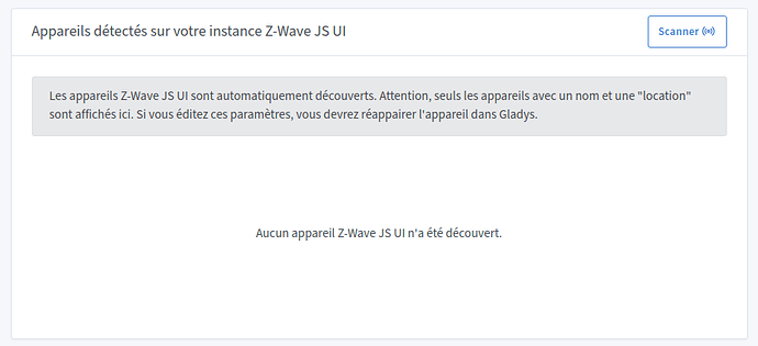

I continued my tests and found a few issues. Maybe you covered these points during the live, but I didn’t have time to fit 7.5 hours of video into my days. I’ll look during my vacation.
I was surprised not to have any messages saying that the devices are not yet supported.

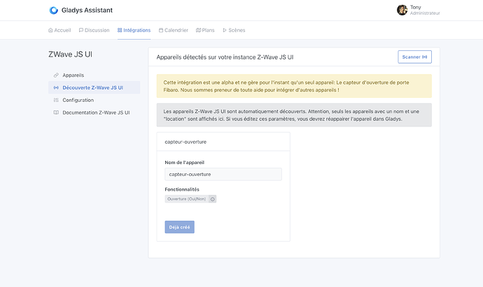

Once the devices are detected, I see two problems. The first is that I can save even though they are not supported — it’s a small detail but I think it could be confusing.
The second is about the name — I have one device per room named Radiateur (5 in total) and I don’t know which is which. I could change the name in zwave-js-ui but I don’t find it logical since it controls a radiator.
In ZwaveJSUI they are differentiated by « location ».
Maybe display « location » then?

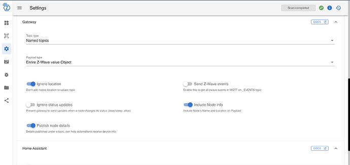

Indeed I hadn’t noticed, but everything is configurable in Z-Wave JS UI.
If we switch to this configuration:
I receive on:
zwave/capteur-ouverture/notification/endpoint_0/Access_Control/Door_state_simple

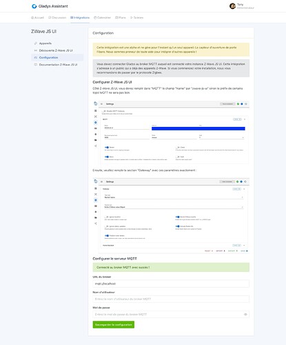

  • Clear explanations regarding the MQTT prefix used and the different settings required in Z-Wave JS UI for the integration to work.

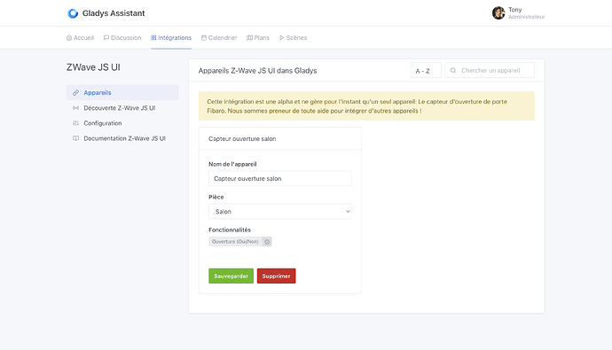

  • Added a message to specify that this integration is in alpha and that only one device is supported
The current integration looks like this:
The updated PR (pull request): Z-Wave JS UI integration by Pierre-Gilles · Pull Request #1982 · GladysAssistant/Gladys · GitHub
I also worked on the documentation, to test in demo here:
