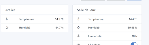

hey, I have the impression that it’s not refreshing very often (it could well be on the order of half an hour there)
is that configurable, do I have a problem, or did I forget something?
yeah clearly I’ve got a problem here :
it’s 19.2 and 19.0 in those rooms right now (and my heaters take a while to manage to raise the room by +3°)
