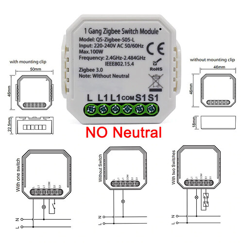

Connected Module for Standard Switch
So far I have only tested one, the QS-ZIGBEE-D02-TRIAC-LN model, at €18 on Aliexpress.
You need to be careful with this model, only « push » type switches are compatible, those on which when you press the button returns to its original position.
It is quite small to fit behind a flush-mounted switch, responsive and the dimmer works on my LED lamp (basic IKEA 5W, not connected).
The only place where it does not work well for me is my living room which has a luminaire with 6 LED bulbs of the « old school » type. Despite the presence of 6 bulbs and the addition of a Legrand resistor, nothing works, everything flickers when I turn it on.
I read on the product page that a minimum consumption is required for the module to work correctly in « no neutral » mode. This is a possible explanation, I will rather use a connected switch in my living room!

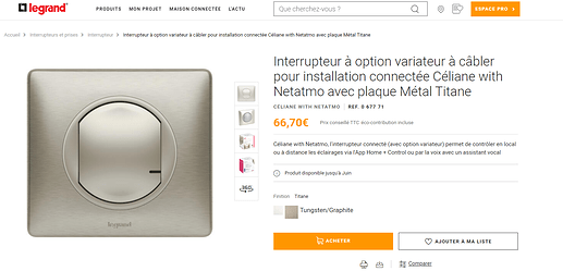

Update : LEGRAND Switch
  • Context : In my living room, I have a light fixture with 6 bulbs. In winter it’s too bright despite the low consumption of the LEDs (3W to 4W each). I also regularly get flashing or flickering in the evening, which is quite annoying
So I decided to invest in switches from the highly renowned brand LEGRAND. For those who don’t know, it’s one of the largest French manufacturers of electrical equipment.
:play_button: They created a range « Céliane with Netatmo » part of which uses Zigbee :
I therefore created a search on Leboncoin to include all the models referenced by Zigbee2MQTT : https://www.leboncoin.fr/recherche

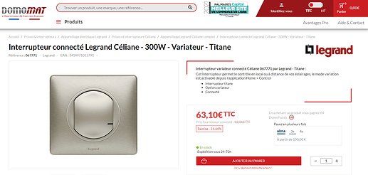

Price
I managed to buy it for €38 on Leboncoin, with the active compensator included. It’s a small component to plug as close as possible to the bulb.
Otherwise new, I could quickly find it between €63 and €66 on the official site — maybe you better understand the Leboncoin option? :joy:
(It comes in several colors. Mine is white).

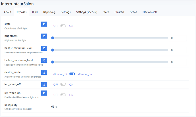

Features
  • On / Off
  • Night light On / Off (only On, only Off, or both)
  • Dimmer when pressing and holding up or down
  • Controllable via Zigbee, of course
Gladys preview :
Zigbee2MQTT preview :
Feedback
I’ve only had it for a few days but the verdict is already excellent.
  • No more flashing or flickering
  • I can adjust the brightness
  • Installation is easy, no neutral wire required, and it fits into the wall without forcing
  • It is recognized very quickly by Zigbee2MQTT and Gladys
