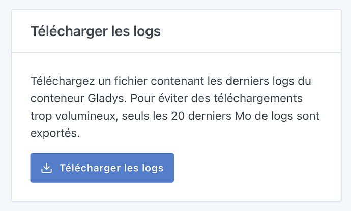

Could you download Gladys’s logs in Settings → System and send them to me by email?

The logs should help us quickly identify what’s happening.
