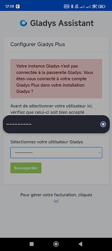

Well… here we go again.

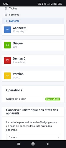

However I’m properly connected to the internet:
On your side @pierre-gilles, is there nothing wrong with the Gladys Plus connections?
There might be a small confusion: the « 33ms ping » only means that your frontend is connected to the Gladys backend (purely local), it does not mean that Gladys is connected to the internet.
No particular issues yesterday with the infrastructure. I don’t have per-instance details, though.
