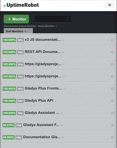

For info, I use https://uptimerobot.com/ with notifications via Telegram, it’s super convenient!
But I don’t know if it handles sockets.
I use it too :slight_smile:
It didn’t detect the downtime unfortunately.
