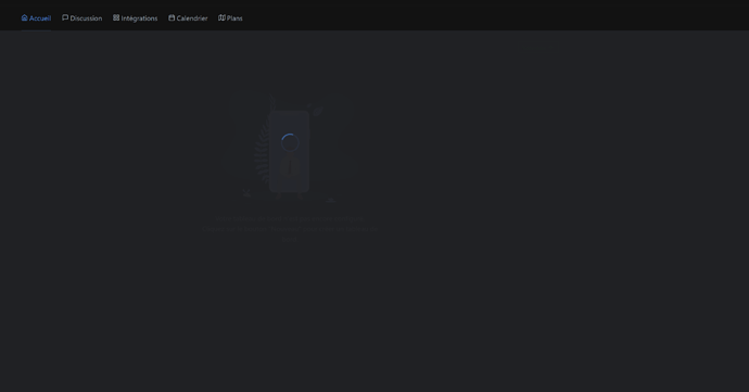

Hello!
It seems Gladys Plus is down again for me :confused:
Here are the details:

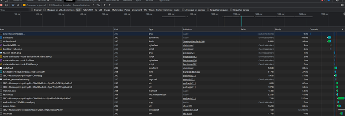

I checked my analytics; I don’t have the impression there was any interruption at those times. Are you sure it’s not your local instance that was having trouble responding (aggregation running, Gladys Plus backup in progress that locks your database, etc.)?
Especially since in your screenshot we can clearly see that all requests are responding successfully, so it doesn’t look like a Gladys Plus downtime.

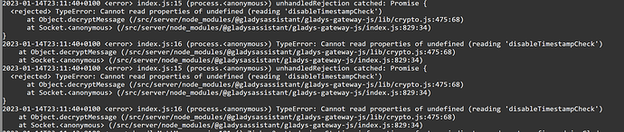

I assume the log you’re showing comes from your local instance; it looks more like a message parsing problem.

I looked at the code, I think I understood
Is your office PC’s clock set correctly?
The error you see is that the message is seen as « expired » by the Gladys instance, the signature is too « old ». It’s a security measure to prevent « replay attacks » ( Attaque par rejeu — Wikipédia )
If your PC’s clock is wrong, Gladys will think this request comes from the past and is a « replayed » message by an attacker.
For info, a message expires after 5 minutes, so there must not be a time difference of more than 5 minutes between your PC and your Gladys instance, check that :slight_smile:
