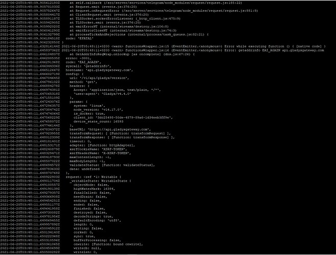

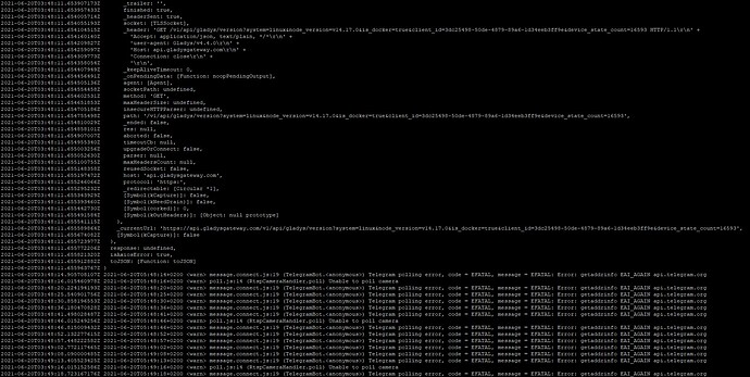

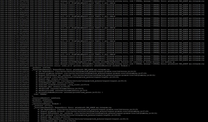

While searching in the logs, I found this: Sorry, we can’t attach a txt file
According to the logs, the error is EAI_AGAIN, which is a DNS lookup error.
I think I read in the news that Orange had a DNS incident recently, by any chance are you with Orange?
In any case, if you haven’t changed anything on your Pi, the problem isn’t really from Gladys, it’s more of a network issue in this case. Many possible causes!
