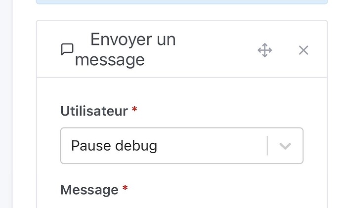

For debugging, as @guim31 says you can send yourself messages with or without variables (Telegram in my case).

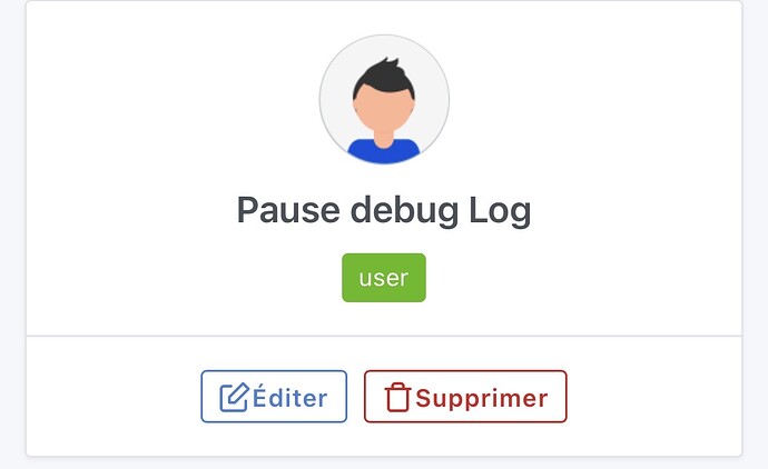

And when you need to keep the Send a message actions but want to stop receiving messages temporarily, you can create a dedicated user:

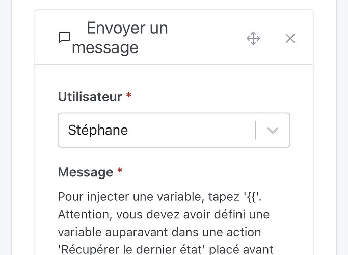

And then in your scenes you just change the user:
This lets you reactivate it when needed.
