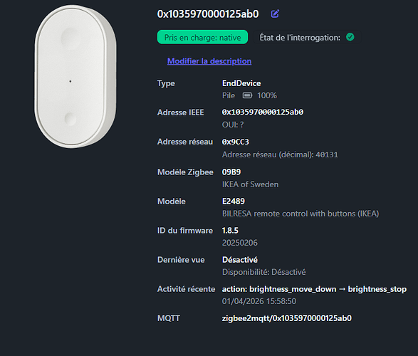

I am now wondering about the different states, based on the model I have, the different states are:
Action Z2M Interpretation
on single click top button
off single click bottom button
on_double double click top
off_double double click bottom
brightness_move_up long press top
brightness_move_down long press bottom
brightness_stop release from a long press (top or bottom)
Yes, that’s it, in a scene you can already use those in the trigger block, you will find them under these names
« On », « Off », « Increase brightness », « Reduce brightness », « Stop brightness »
For the doubles that are added with the ongoing PR, they will have this name
« On double », « Off double ».

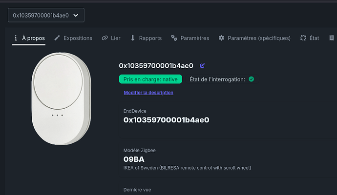

I managed to detect the version without the roulette, but the version with the roulette won’t cooperate, it’s flashing in all directions but that’s all…
Any advice?
I’ve been trying for 15 minutes -_-
EDIT: After changing the batteries, it worked perfectly

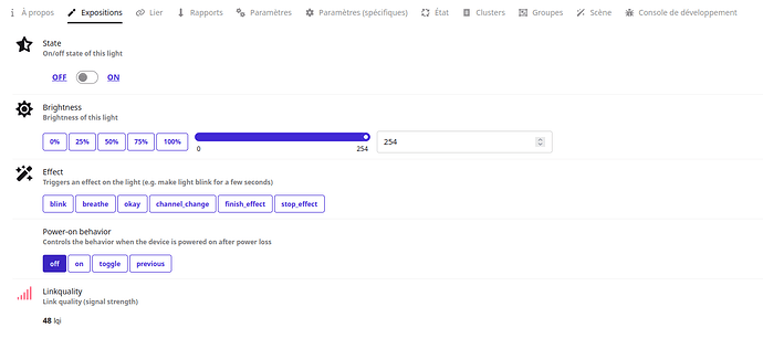

I have a question about the roulette model,
when you spin the roulette, it triggers brightness_move_to_level on the Zigbee2mqtt side but nothing on Gladys.
And the event sends a value between 0 and 255 + null beyond.
Is this type of event usable in Gladys?

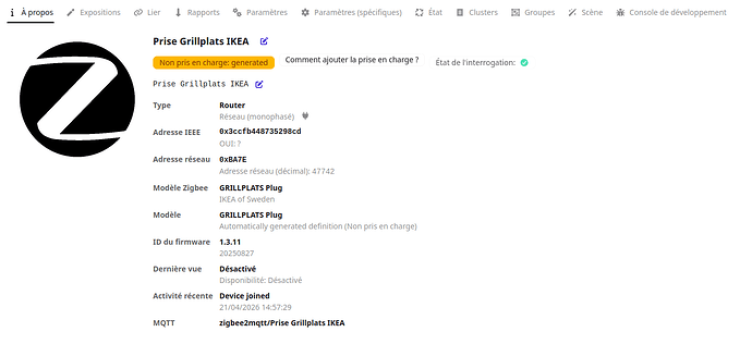

And for information, the IKEA Grillplats power outlet also passes:
even if it is not fully recognized in zigbee2mqtt:
And I have a difference between what the web page announces and what zigbee2mqtt displays to me…

No, I don’t think we have a function for this type of parameter; additional development will be needed on our side.
There seems to be a PR in the Zigbee2mqtt repo. Your outlet should be fully functional once this PR is merged.
Thanks for your feedback :slight_smile:
