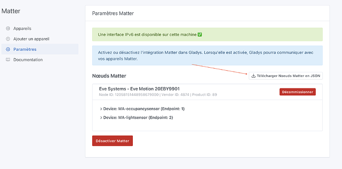

This file is normally found in the Matter integration Settings.
Thanks, I see where that file is (it’s about Matter nodes). I’ll wait for @pierre-gilles to ask me for it if he needs it.
Indeed, these IKEA buttons are brand new and I think you’re one of the first to have them in Gladys :slight_smile: We’ll add it, don’t worry!
Could you provide us the JSON file you get by clicking on this button:
You can host it on https://pastebin.com/ for example, and don’t worry there is no sensitive information in this file, it’s just generic information about the functions exposed by your device :slight_smile:

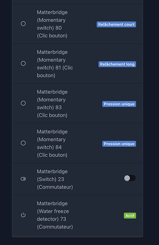

I worked on this topic and submitted a PR here :
I tested with Matterbridge and it seems to work :
Now I’m hesitating to pop over to IKEA to test it in real life with a BILRESA — it could even make a video for the YouTube channel :smiley:
But not sure I’ll have time today, I’ve got a busy day ^^
The new features are available in Gladys Assistant 4.71 :
@micmac I’d welcome your feedback, because I didn’t test with physical devices but with Matterbridge! We can make changes if it doesn’t work :slight_smile:
