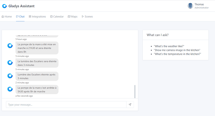

Edit: Well, I did it now after all ^^ It works perfectly, at least for 2 scenes at the same time. We’ll need to take the time to test with more.
Proof in picture ^^
