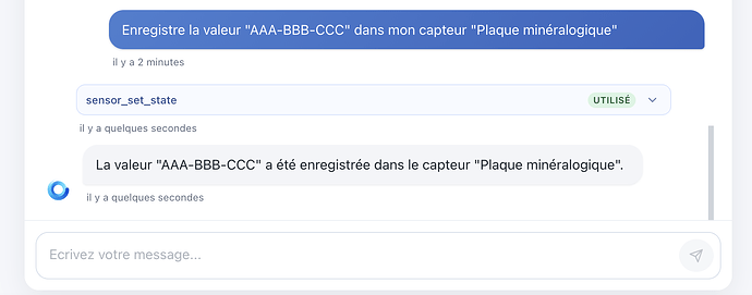

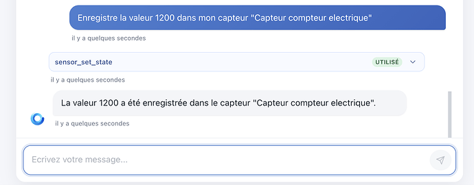

Hope I’ve added the new tool, it was pretty easy!
Tested in the chat, but it will work the same way in the scenes:
This will be ultra convenient for using AI to read values from meters :star_struck:
