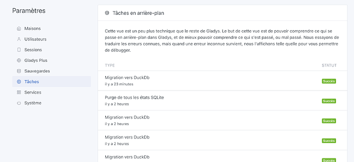

I made good progress again today, the user will be able to track whether the migration took place successfully in the System tab:
They will be able to purge the SQLite states themselves (this won’t be automatic at first, to leave control to the user).
In the « Tasks » tab, they can see the migration task progress live / the errors if there are any:
I find the interface clean, cool. I imagine that the « purge SQLite states » button won’t be enabled until the migration has been completed…
And on the other hand, while I think it’s good that a manual action is required to delete the data from the SQLite database, I don’t see the point, from a user perspective, of having to perform two manual actions: purge, then clean up. Is there a reason for that?
Not a bad point, I’ll change that :slight_smile: It wasn’t the case until now!
Purging is a background, non-blocking action. You can run the purge during the day without issues; it deletes in batches little by little. It can take time, though, but it’s non-blocking.
The cleanup is a SQLite command (« VACUUM ») that is blocking — Gladys is completely blocked while it runs. On a very fast NVMe SSD on a mini PC, the downtime will be short.
On a USB SSD on a Pi, or worse on an SD card, the blocking can take several hours (this is noted on the cleanup button).
So I preferred to separate the two actions so the user can choose when to schedule each action.
If we chain the two together, and you start the purge while Gladys is running, then 2 hours later it moves on to cleanup and Gladys gets blocked, the user might not understand and will think it’s a bug!

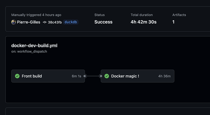

I started a manual Docker build early this afternoon to run tests on a Raspberry Pi…
![Screenshot 2024-07-15 at 16.34.01|690x241](
I don’t know anything about it, but couldn’t it be put into a ‹ cache ›-type system?
If not, it’s going to be a pain for you!
That’s already the case :slight_smile: In any case, you do need a first build to initialize the cache / renew the cache when dependencies change
it took more than 4 hours in total anyway:
Afterwards, the question of support for armv6/v7 comes up — we have other things that no longer work on armv6 (notably Node 20), and we’ll probably soon be pushed to abandon that platform… (no more Pi Zero in particular, but then, does Gladys really aim to run on those machines, knowing that even on a Pi 3/4 it doesn’t run very well ^^)

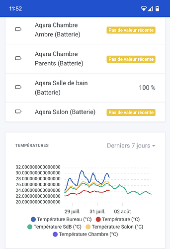

Initial feedback: the values are not truncated / rounded
Thanks for the feedback @cicoub13! Did you leave it running or just test it once?
Regarding the rounding, I’m aware — I had opened a separate PR because the issue is already present in production right now, but I think I’ll merge that PR into the DuckDB PR and rebuild!
It’s been running since Friday.
Zigbee2Mqtt / MQTT / Enedis / OpenWeather / Camera and Telegram OK
I just merged the PR to remove the extra zeros from the charts and relaunched a build
Build time about 4h15 :sweat_smile:
Edit: crazy, with the Docker cache it only took 1 minute :slight_smile:
