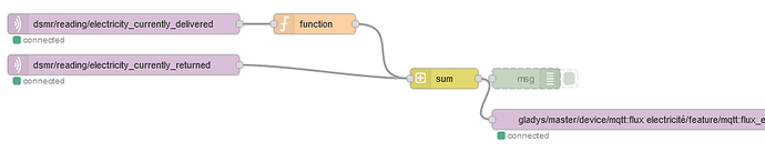

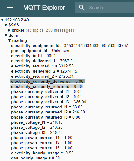

  • the values come from MQTT streams generated by a device based on an ESP connected to the P1 port of my ‹ smart › meter, the Belgian equivalent of the Linky, and which I ‹ process › in Node-RED then send back via MQTT to Gladys.
