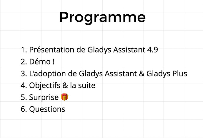

The schedule for tonight’s live!
Little surprise at the end :wink:
