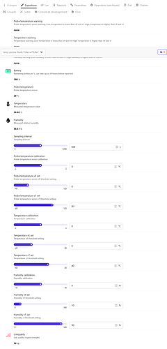

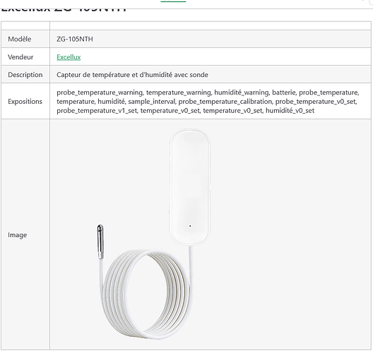

I would need a bit of help with this temperature probe:
It is well declared on Zigbee2mqtt. Here is what it exposes:

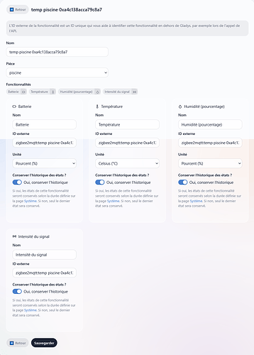

In Gladys, I retrieve information, but not the « Strobe Temperature ». The only one that comes up is the temperature measured at the housing:
Here is what Gladys retrieves in the Zigbee2Mqtt integration:
My question is: is it possible to retrieve « the probe temperature » in Gladys?

So you already have the Temperature and you want Probe_Temperature, is that right?
If that’s the case, yes, it’s easy to add. I can open a PR this week.

Yes, the temperature that is transmitted is the value measured by the box, but the temperature measured with the probe does not go back to Gladys. If you have time to make a PR, that would be great, thank you very much. I admit, I’m a bit overwhelmed with all these innovations with AI.

Thank you so much, the temperature probe recovery is working well
