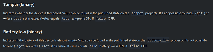

I looked and yes, the 2 functions you’re asking for are not implemented in Gladys.
Ci dessous les 2 exposes manquant.
As for the charge level, however, it’s not really the level but just whether the battery is low or not.
As soon as I can I’ll look into integrating these 2 exposes into the integration.

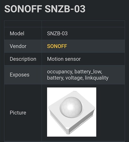

Since there had been a concern regarding battery management between two development versions, I added a Sonoff motion detector. On the prod side, only the battery level property is offered. In the test I ran, there are both: level and battery low (yes/no). It shows me a level at 100% and battery low « no » in green. So the two seem to coexist correctly. I say « seem » because I don’t know how the « battery low » property behaves when the battery is depleted (because I don’t have one on hand).
Thank you for the test.
OK regarding the battery.
In the case of your sensor it’s normal that you now have both in the test because the two exposes (battery and battery_low) are available for this sensor
