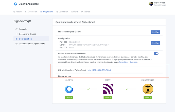

However, it’s not stated anywhere in Gladys’s documentation on Zigbee2mqtt that you can access the raw Zigbee2mqtt interface via the port. Which means the average user doesn’t know they can configure their hardware more finely.
And that’s understandable since Gladys is designed to be user-friendly.
That’s why being able to change the settings in Gladys would be a plus. It would avoid having to get your hands dirty.
Yet it’s right there in the interface, accessible in one click :
I agree that it could be a plus; however, it’s work, and that work must be weighed against other requests.

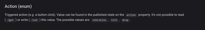

No, I don’t see anything that could help us in the payload returned by this sensor.
And in the doc there is only the info below
