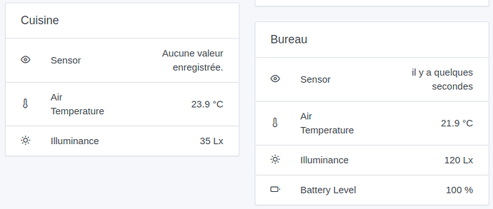

I have 2 FGMS001 motion sensors and 2 FGMS001-ZW5 motion sensors, as well as a smoke sensor and connected outlets (all FIBARO).
The 2 FGMS001 sensors work very well and return the information correctly. However, the 2 FGMS001-ZW5 sensors do not return motion detections.
PJ = 1 sensor of each.
I also have a problem with the smoke sensor which does not return a battery status.
If you have any ideas to help me or if you have the same problem, I’m interested :slight_smile:
