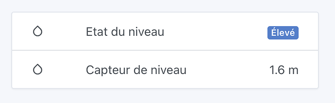

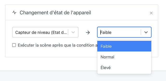

I integrated this device in this PR:
Everything is handled, including the level state (low/normal/high), which you can use on the dashboard and in scenes! :smiley:

@StephaneB I made a new build with:
  • Fix for the unit (meter)
  • Creation of a custom feature type for this device to have personalized names
You need to pull/delete/recreate the container, then delete the device in Gladys / then re-create it from the discovery tab to get the changes :slight_smile:
