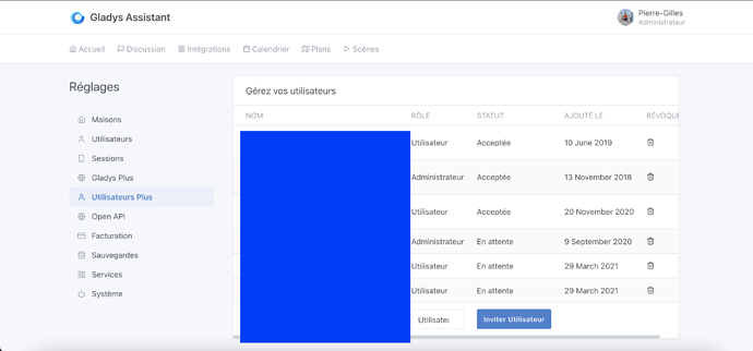

Can you confirm that you are on https://plus.gladysassistant.com, « Settings » => « Plus Users », and that you do:
That’s exactly it @pierre-gilles!

Indeed, there are a few errors when I click the button!
Here’s what I get with a click:
Ok @Mastho, I understand, it was quite silly. You had already invited the user to Gladys Plus, then removed access to that account.
I just realized there is a check when you invite someone that blocks the invitation if the person has already been invited (to avoid double invitations), but in your case you invited and then deleted, so it doesn’t make sense to prevent re-inviting.
  • I deleted the old invitation (so it should work for you now)
  • I will change this constraint, it’s normal to be able to invite someone again if you have removed access
  • I will put a more explicit message in the UI for the user ^^
