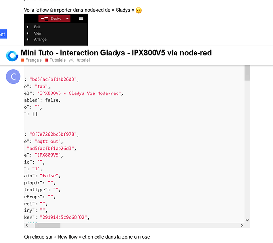

For the flow, I still have the same error I had with cce66, there are quotes on each line, which are not the right ones, and which cause the copy-paste to crash. We need quotes like this " and not like inverted commas, I don’t know where it comes from. :thinking:
Hello cce66,
How do you practice to get your flow in a window with a scrollbar? Because the quotes are good here.
type or paste code here
You first need to click on </> then this displays
You then need to paste the code instead of « type or paste code here »
