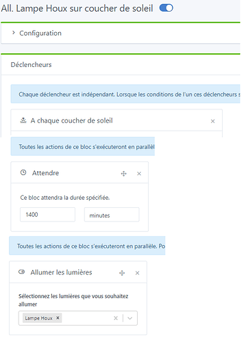

For those who come across this topic, an « after » delay as such is already possible — you just need to add a « wait » action in the scene. For a « before » delay, indeed it’s not possible at the moment :slight_smile:
I am currently using « At each sunrise » to open the roller shutters.
But it is already daylight for some time when they open.

I have a very simple solution that allows me to configure triggers in scenes in advance of sunrises and sunsets.
I tested the « attendre » function with values in whole hours or directly in minutes, for delay values beyond around 8:00 PM, and it allows managing the trigger ahead of sunrise or sunset.
However, the accuracy depends on the amount the sunrise and sunset times varied from the previous day :wink:
