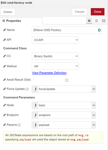

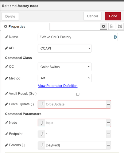

I finally found it
For those who want to do the Zwave integration directly in NODE-RED with ZwaveJS
In the factory you just have to indicate the endpoint and the params which will be your payload
Then the class that corresponds to your action
