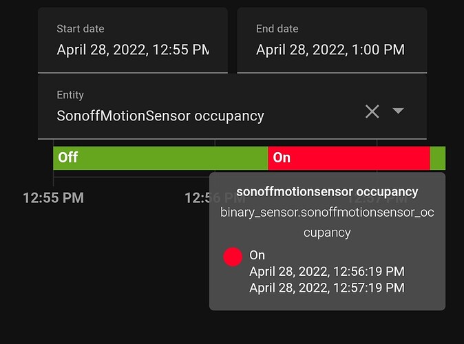

On Xiaomi devices, this is configurable, but on Sonoff motion sensors SONOFF SNZB-03 control via MQTT | Zigbee2MQTT, this occupancy parameter is not configurable.
How can this be managed?
We can’t, it’s not adjustable.
I have a Sonoff and it must be 2 minutes for the timing.
Edit: it’s 1 minute.
Ah, I had a feeling.
