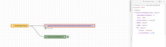

So I managed to get Node-red to communicate with Gladys.
But now I’m stuck: the information returned by the Solaredge API is in JSON format. I get all these values:
The one I’m interested in right now is currentPower.
But I don’t know how to extract it from this JSON and send it to Gladys. Do I need to « parse » something? I’m not even sure that’s the right word ^^

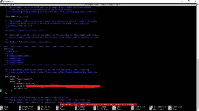

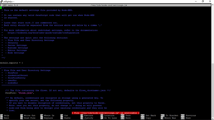

Hello, I tried to integrate Node-RED. I’m almost done, I’m stuck when I edit the settings.js file. I use the following command « nano /var/lib/node-red/settings.js »
I get this with a red alert at the bottom of the screen.
I edit the necessary part and I change the password, I press ctrl+x, yes and Enter and I get this.
And now I’m stuck, I also have a red alert at the bottom of the screen.
