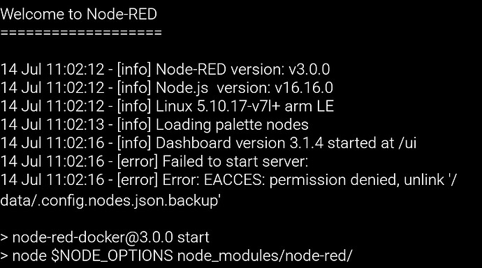

Welcome to Node-RED
15 Jul 12:38:00 - [info] Node-RED version: v3.0.0
15 Jul 12:38:00 - [info] Node.js  version: v16.16.0
15 Jul 12:38:00 - [info] Linux 5.15.0-41-generic x64 LE
15 Jul 12:38:01 - [info] Loading palette nodes
Fri, 15 Jul 2022 12:38:07 GMT node-telegram-bot-api deprecated Automatic enabling of cancellation of promises is deprecated.
In the future, you will have to enable it yourself.
See https://github.com/yagop/node-telegram-bot-api/issues/319. at node:internal/modules/cjs/loader:1105:14
15 Jul 12:38:08 - [info] RedBot version: 0.19.19 (node-red-contrib-chatbot)
15 Jul 12:38:21 - [info] Dashboard version 3.1.7 started at /ui
15 Jul 12:38:22 - [error] Failed to start server:
15 Jul 12:38:22 - [error] Error: EACCES: permission denied, unlink '/data/.config.nodes.json.backup'
