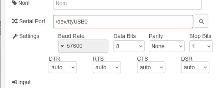

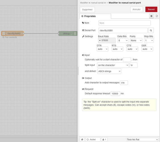

In Node-RED, I select the suggested port :
Configuration in Node-RED :

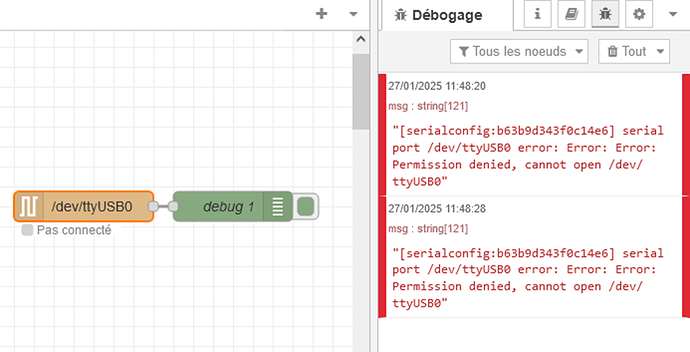

When deploying :
Node-RED logs

I’m back on Node-RED and RFLink, I run this command :ls /dev/tty*
pi@rasp3b:// $ ls /dev/tty*
/dev/tty    /dev/tty14  /dev/tty20  /dev/tty27  /dev/tty33  /dev/tty4   /dev/tty46  /dev/tty52  /dev/tty59  /dev/tty8
/dev/tty0   /dev/tty15  /dev/tty21  /dev/tty28  /dev/tty34  /dev/tty40  /dev/tty47  /dev/tty53  /dev/tty6   /dev/tty9
/dev/tty1   /dev/tty16  /dev/tty22  /dev/tty29  /dev/tty35  /dev/tty41  /dev/tty48  /dev/tty54  /dev/tty60  /dev/ttyAMA0
/dev/tty10  /dev/tty17  /dev/tty23  /dev/tty3   /dev/tty36  /dev/tty42  /dev/tty49  /dev/tty55  /dev/tty61  /dev/ttyprintk
/dev/tty11  /dev/tty18  /dev/tty24  /dev/tty30  /dev/tty37  /dev/tty43  /dev/tty5   /dev/tty56  /dev/tty62  /dev/ttyUSB0
/dev/tty12  /dev/tty19  /dev/tty25  /dev/tty31  /dev/tty38  /dev/tty44  /dev/tty50  /dev/tty57  /dev/tty63  /dev/tty-usb-arduino-nano
/dev/tty13  /dev/tty2   /dev/tty26  /dev/tty32  /dev/tty39  /dev/tty45  /dev/tty51  /dev/tty58  /dev/tty7
For the last USB ports, I see the port /dev/tty/USB0 and then there is this port /dev/tty-usb-arduino-nano.
They are the same ports because when I unplug the RFLink both ports disappear.
However on the miniPC, I do see the port /devttyUSB1 (when I plug in the RFLink) but not the renaming to « /dev/tty-usb-arduino-nano », knowing that on the miniPC, I’m on external Node-RED.
Is this normal? Is the USB port renamed in the internal Node-RED and is that why we don’t see it?
Thanks for your help
You must have created a udev rule that is valid on the host but not available in the container!
Hello @pierre-gilles
I didn’t create anything, if there are udev rules, they come from the installation of Node-RED by Gladys :thinking:
udev rules don’t appear by magic :stuck_out_tongue:
I didn’t create any udev rule, however /dev/tty-usb-arduino-nano is a symbolic link that is created, I think when the RFLink is plugged in. I saw a table that creates the mappings when an Arduino Uno or an Arduino Mega is plugged in,
rasp3b:/etc/udev/rules.d $ sudo nano 99-gladys-tty.rules
So according to my research, I found that this symbolic link (as Gemini said) has permissions like this :
pi@rasp3b:~ $  ls -l /dev/tty-usb-arduino-nano
lrwxrwxrwx 1 root root 7 Feb 19 10:02 /dev/tty-usb-arduino-nano -> ttyUSB0
and the Usb0 port to which /dev/tty-usb-arduino-nano is linked has the following permissions :
pi@rasp3b:~ $ ls -l /dev/ttyUSB0
crw-rw---- 1 root dialout 188, 0 Feb 19 10:02 /dev/ttyUSB0
So I did a sudo chmod a+rw /dev/ttyUSB0, to give permissions to « OTHERS »:
crw-rw-rw- 1 root dialout 188, 0 Feb 19 11:50 /dev/ttyUSB0
and now my « node serial » connects:
  • I don’t know what that is worth in terms of security?
  • the problem is that every time the RFLink disconnects the USB0 port permissions reset to
crw-rw---- 1 root dialout 188, 0 Feb 19 10:02 /dev/ttyUSB0`
and so we lose the Node Serial connection.
These permissions should be fixed so that they are initialized correctly when the RFLink is plugged in. And maybe even for other ports, if multiple devices are connected (Xiaomi gateway, or Arduino Uno board, …)
So if you can do that when you have some time, I’d be happy to test the new image
Thanks
