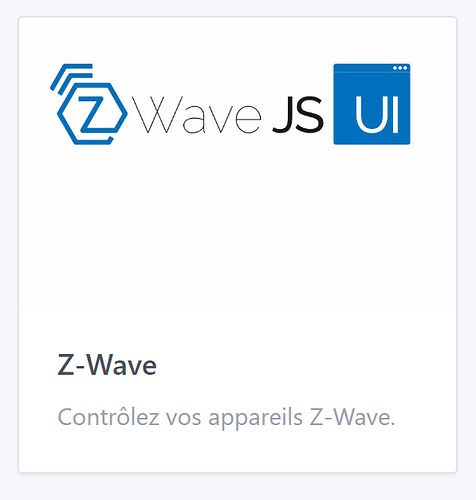

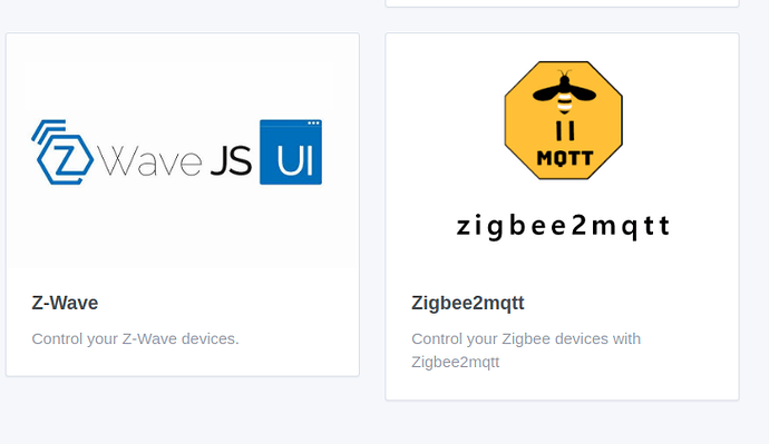

On the integration page, I find that the image is not in the right format:
(note, you need to search for « z-wave » with the dash)

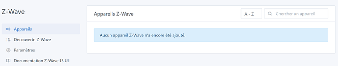

If the devices list is empty, we don’t show a blue « alert » square on the other integrations; instead we usually show a text. It’s not very important, but it breaks consistency with the other services.

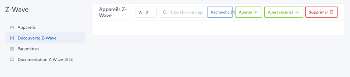

Display issue on a medium-sized screen:

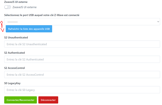

Labeling issue with code:
Spacing and understanding issues (I’m not at all a Z-Wave expert, I don’t know whether I should fill in all the fields, or even what they mean, a small explanatory panel would be appreciated

Then I went to the « Discovery » page, having not yet connected any device other than the USB dongle, and the search keeps looping.
I’m afraid that this kind of active-search behavior might block other exchanges in other Gladys services.

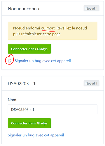

I can see devices in the Discovery tab, but I’m perplexed:
1st case (node 4):
  • I’m not sure that « dead node » is a good wording
  • the name is « dead », but it seems that you can still « connect it in Gladys »
  • on this card, the link looks correct, with the external link indicator
2nd case (node 1):
  • I can correctly add my device in Gladys
  • even though it has no feature
  • so I have a useless device in Gladys
  • if it has already been added, I don’t know it from the Discovery tab
  • on this card, the link is less clean than in the 1st one, the external link indicator is not displayed
EDIT: I can see my dimmer
For information, this device without features is a dimmer switch.

« Mort » or « Dead » is the Z-Wave wording; after all it’s a question of timing because if the device is awake, it will be recognized since at least one message is received from Z-Wave JS UI. Also, I reviewed the messages from the old Z-Wave

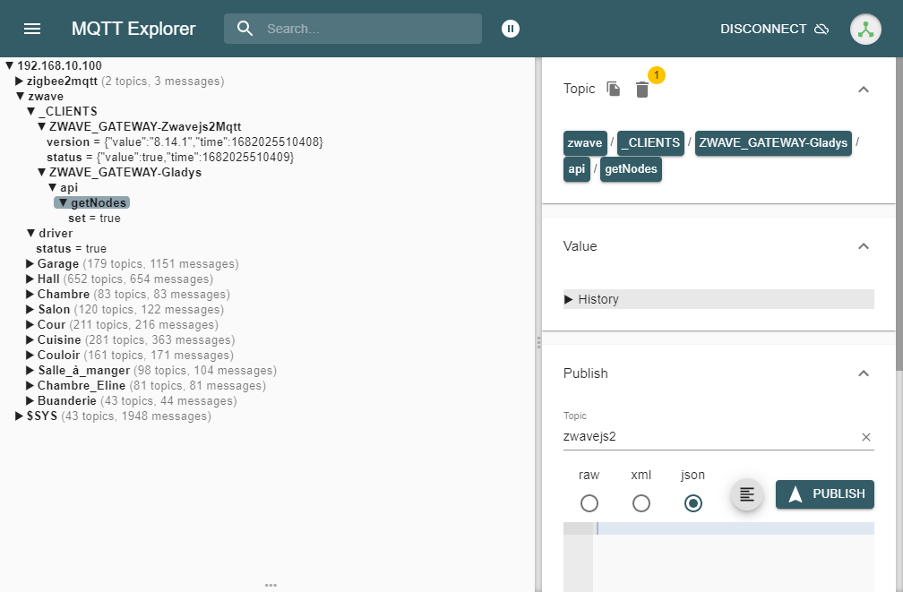

Do you have an MQTT explorer, like MQTT Explorer? You should see a message on the topic: <zwave-js-ui_prefix>/_CLIENTS/ZWAVE_GATEWAY-Gladys/api/getNodes
Otherwise can you send me the logs from your Gladys instance?
Good evening,
Here is what I have in MQTT Explorer:
No problem giving you the Gladys logs, but you’d need to tell me how I can retrieve them via Docker.
You don’t have anything in the getNodes topic? Is that your production Z-Wave JS or was the installation done by Gladys? I had an issue 2 days ago after a Z-Wave JS update; nothing worked for me, I had to redo an update to get everything back to normal…

This is my production zwavejs. I don’t have anything in the topic you pointed me to.

2023-04-23T20:53:06+0000 connect.js:152 (MqttClient.) Connected to MQTT container
2023-04-23T20:53:06+0000 connect.js:154 (MqttClient.) Listening to MQTT topics zwave-js-ui/#
2023-04-23T20:53:06+0000 connect.js:154 (MqttClient.) Listening to MQTT topics zwave/#
2023-04-23T20:53:06+0000 handleMqttMessage.js:81 (ZwaveJSUIManager.handleMqttMessage) ZwaveJSUI scan in progress. Bypass message.
We can see that it connects to MQTT and listens on the zwave topic. That’s the topic I specified in the config. However, I have no idea why it’s listening on zwave-js-ui.
The logs loop on the last line, it scans but finds nothing.
On the ZwaveJS UI side, I have so much stuff that it’s very difficult to make use of without knowing exactly what I’m looking for.
It’s already odd that it’s listening on 2 topics, zwave and zwave-js-ui…
However, a message is indeed sent to zwave/_
