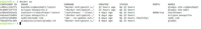

However, I had already installed Node-Red, so I already installed a Docker MQTT and when installing zigbee2mqtt it makes a 2nd Docker MQTT I think.
Maybe the problem comes from there!
Not everything is normal with your containers.
This is not an issue for me, but I understand pascal_sapin question in post 31 better.
On the contrary, there is absolutely the possibility of having several on the same network when there is a large number of objects on the network. When an object subscribes to another object, it specifies the address of the server to which it subscribes, and if the object to which it is subscribed communicates on the same server, it is sufficient for two objects wishing to communicate data between them to be subscribed to the same broker (server). :wink:
