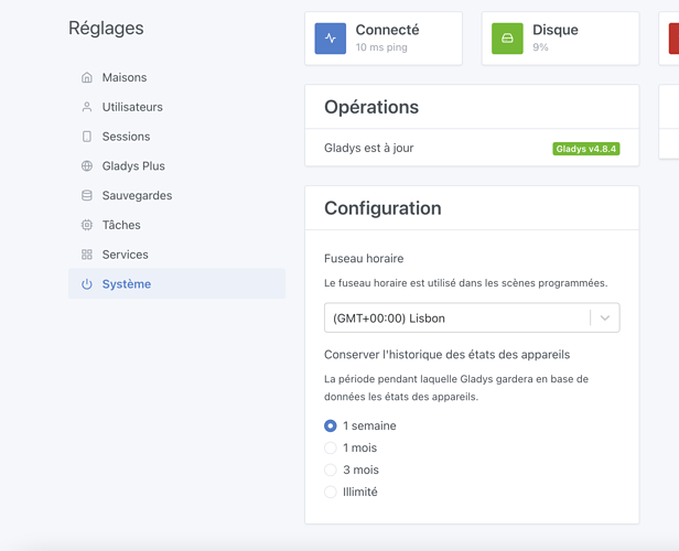

If you want to do a little spring cleaning, you can go to Settings, then « Systems Â», then change the « Retain device state history Â» value to 1 week « temporarily Â» (for at least 24h):
At night, Gladys will run a cleanup of all values older than 1 week, and your DB will be much lighter — this can temporarily free you up (if you don’t care about your old values, of course)
