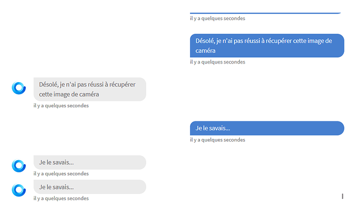

As the happy owner of an online Nextcloud instance and Gladys at home, I was very pleased to see that I could chat with Gladys through Nextcloud Talk.
However, I can’t get it to work properly. When I configure Nextcloud Talk in Gladys, Gladys seems to chat with itself endlessly.
Does anyone have any idea what I’m doing wrong?

Ok thanks, for the moment I can’t reproduce it with my Nextcloud. How is your Nextcloud instance hosted? Is it your own personal instance on your own server? Not an instance offered by one of the official providers (if it’s a provider, can you tell me which one?)
Once you’ve configured the integration on the Gladys side, would you be able to let it run for a few seconds so that a few messages appear in the chat and send us the Gladys logs?
