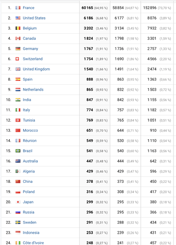

@thierry1 Hmm, it will be complicated if we have to do this country by country. The Gladys community is not just France :slight_smile: According to the site statistics from the last year, visitors come from 182 different countries!
We do have a French dominance, but many other countries that are not negligible! Here are the first 24:

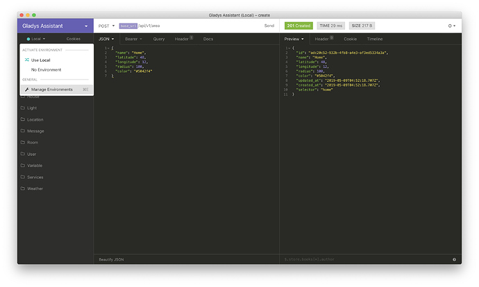

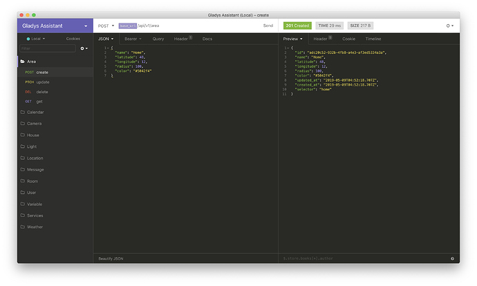

I’ve entered all the Gladys 4 API routes into Insomnia, it looks like this:
With this, it is very simple to test the Gladys API, everything is already entered!

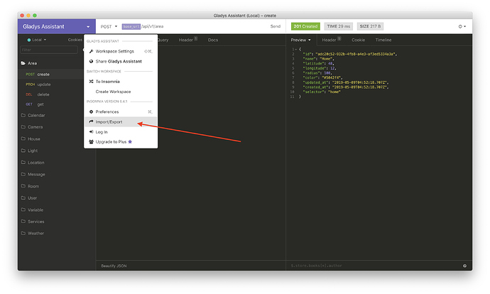

Small tutorial to import this setup at your place
  1. Download Insomnia
  2. Import the insomnia.json file by doing:
Click on « Data » → « Import Data » → « From URL », then copy and paste the URL:
https://raw.githubusercontent.com/GladysAssistant/gladys-4-playground/master/insomnia.json

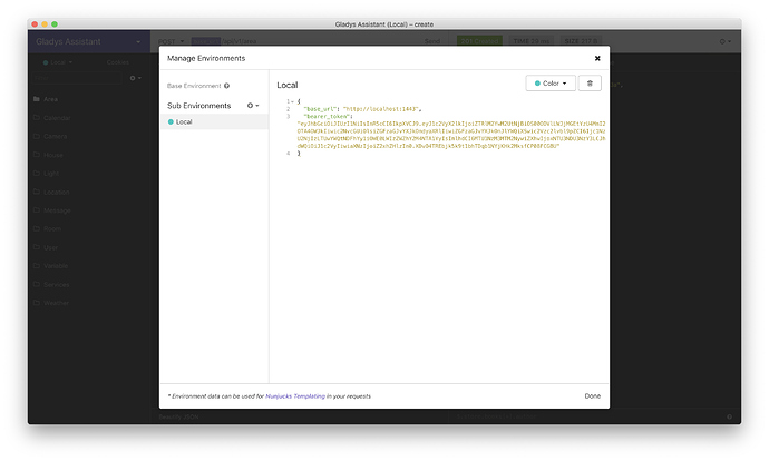

  1. You can modify the environment with your parameters (IP of your instance, authentication token) by going to « Manage environment »
